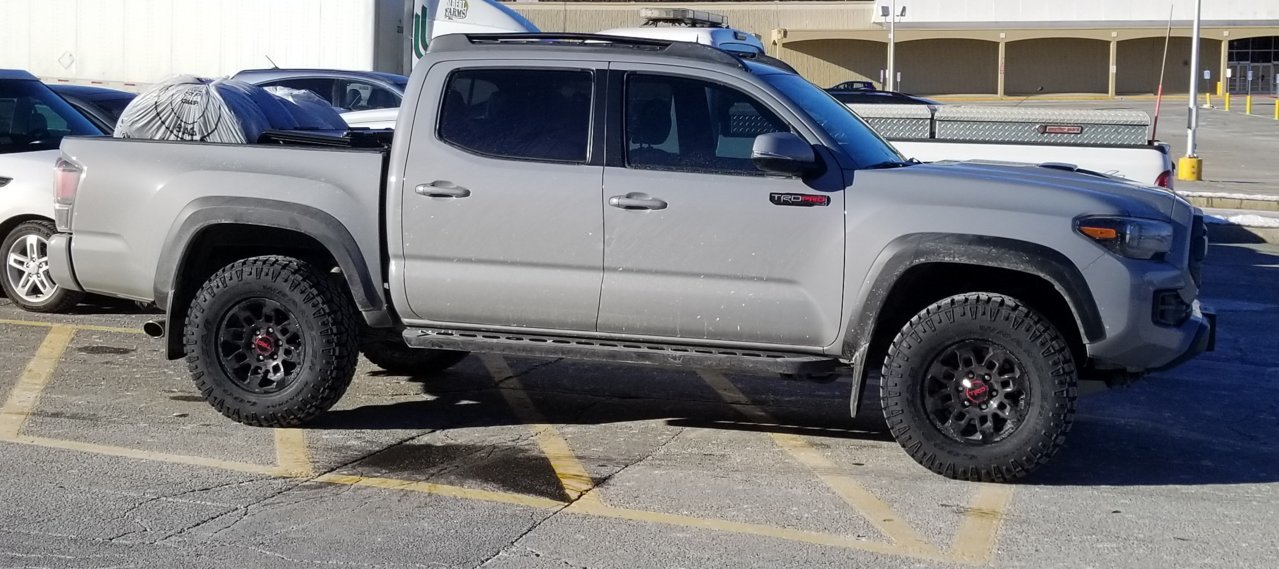

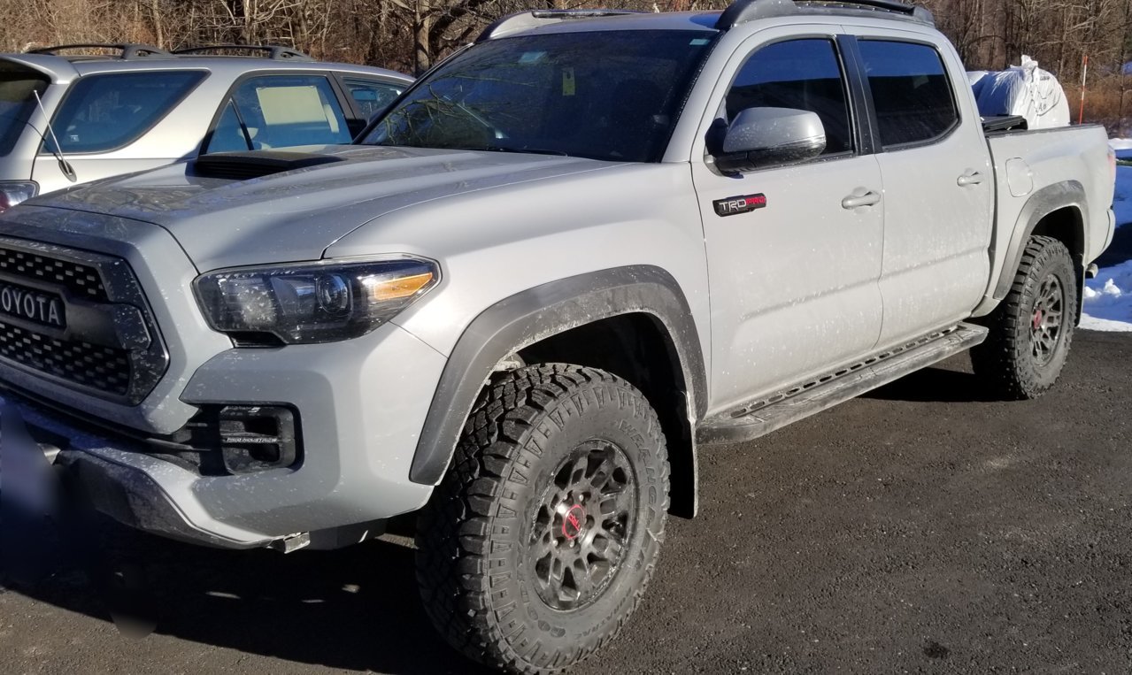

    So I put on some durartracs on over the weekend and I not happy with how the truck is handling the road and I am getting much more road noise that I expected. Bumps are harsh and the ride is extremely stiff. I can feel small bumps and the sidewall just feel really stiff. I have a 2017 TRD Pro and I have been running stock tires since the I bought the truck a couple of months ago(pre-owned). I have this will be my 4th Tacoma and my last truck I had an 05 Taco with a leveling kit and rode duratracs and loved them. Load Range C on on all of them. I have also had BF GoodRich Mud TA, and ALL Terrain KO but always preferred the Goodyear DuraTracs for the New England snow, Ice etc.
    Anyhow, I am wondering if anyone has had this same experience and if there is a solution. I am not counting out going to another tire and I would like to keep it with something that looks good and is functional like a AT or AT Hybrid. I am not looking to go up or down a size, switch wheels or make any additional mods at this time.
    Thanks everyone in advance.
