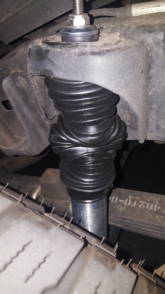

    Thanks for the tip. I did have the 5100 installed front and rear and I noticed the rear shocks is very stiff and harsh when I hit pot holes. I might give the 5125 a try see if that'll do the trick and plus my OCD don't like how the boot is all deformed look . Cheers bud.

    Fix the boot. Its rubbing the shaft as is and if dirt gets in there it can wear away at it over time.

    I have fixed the boot a few times now. When extending the rear end they seem to crinkle back up this way.

    Same here I think that's normal for the boot to look that way. I tried spinning it but same results

    If that's stem/eye, you may want to check your travel and the Bilstein list I put in my original post...Looks like only the 5" and 10" travel stem/eye shocks are valved softer. But you're not limited to the 5125.. the main thing is getting softer valving

    You should be able to slide the upper part of the boot up so it's not so compressed. It's just held on with a zip tie. In your case since the boot is on top slide the lower part of the boot down. I had to do that with mine. The rubber can only compress so much before it gets all deformed.

    I think it is made this way unfortunately because of rubbing. But better than no sock/boot i think. When i got mine the boot was perfect but only because it was not compressed.

    I tried that.

    It honestly looks like you could slide down the bottom part of the boot a bit and it will help. It should be easy enough to do. It's just held on with a zip tie from the factory so it should slide easily enough

    I will try tomorrow again. Hopefully when i go wheeling and extend the shock it will go back nice and not get all crinkly again
