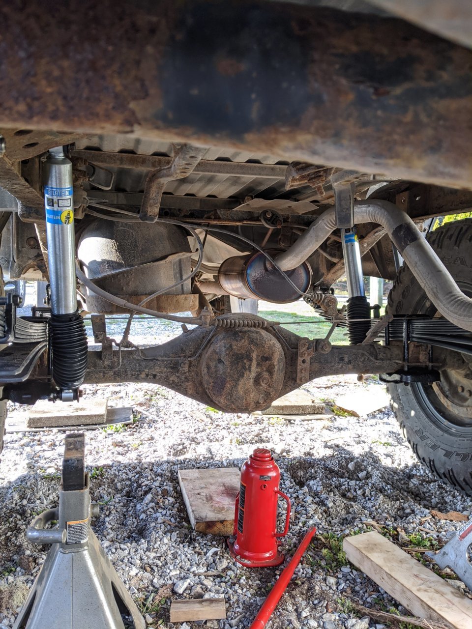

    A+ thread OP good research I've had these on for a week or two now and they soften things up nicely. Better than 5100's and MUCH better than emu.

    From the numerous suggestions from another thread on TW, I ended up buying Bilstein 33-186542 for the rear which appears to have the 255/70 valving. I've paired these with the OME Dakar leafs and their AAL (D43XL?)
    According to the catalogue, they're for 66-77 Ford Broncos and a variety of older Jeeps from the 70's and 80's. Cool!
    I've got no complaints so far about my setup so far. Probably worked out considering I usually have some significant weight in the back when I go camping.

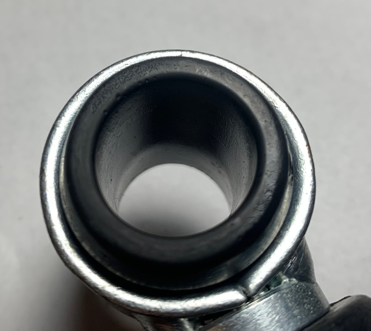

    I picked up a pair of these 5125s and the 9.8108G bushings, got the bushings installed on the new shocks today and went to try to install on the truck. I could not get the shock to slide onto the mounts, either on the frame or on the lower mount. It looks like they should fit, I think I got the right bushings, but there's a small convex bump on the inside of the bushing that I can't push past.

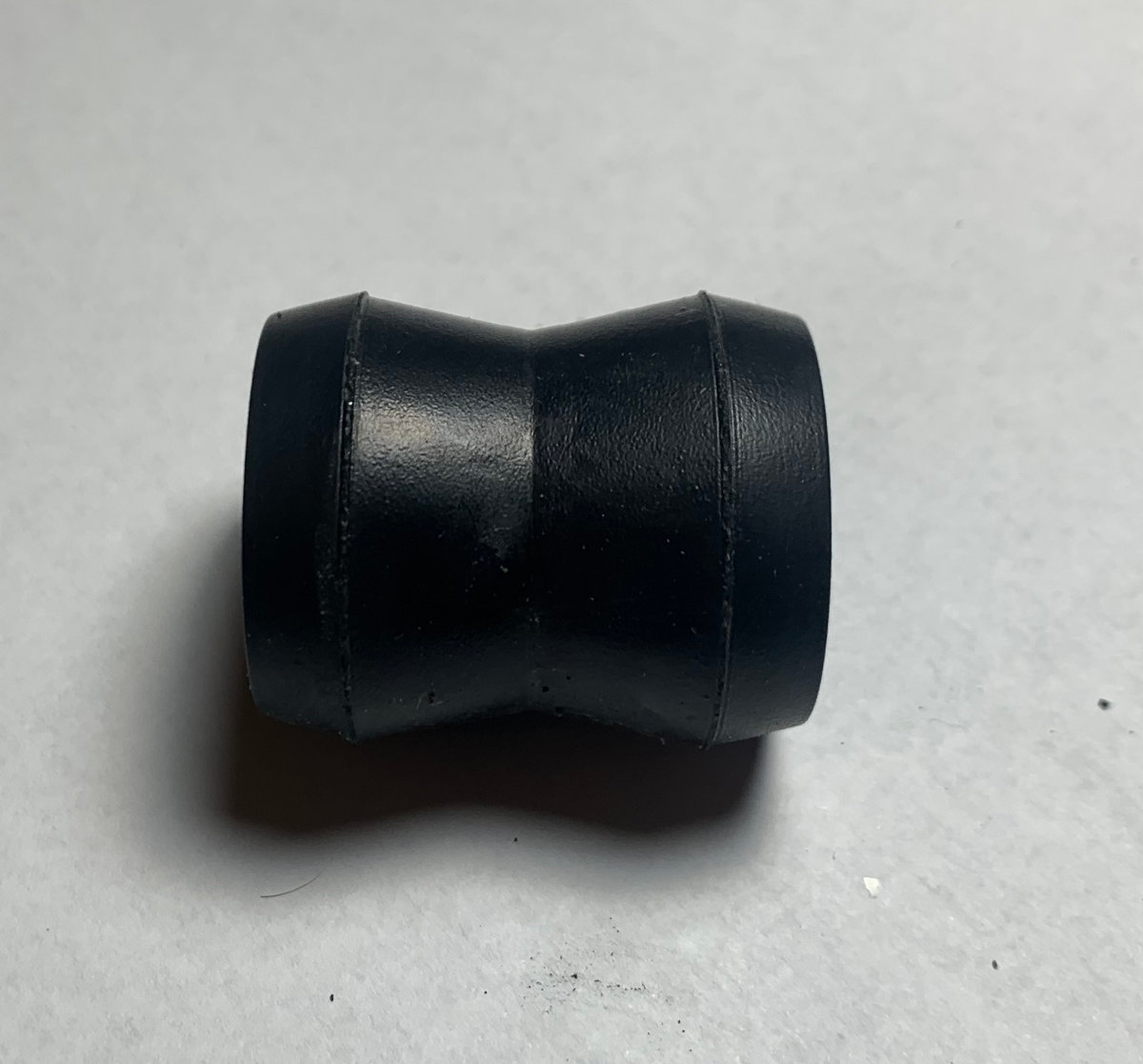

    It's pretty small, I tried taking some pictures and I'm not sure if it's even really visible.
    This is one of the original bushings that Bilstein shipped, it's the center portion of the hourglass bushing that seems to be slightly raised and giving me some resistance. I think I have the bushings seated correctly, but wasn't sure if there were any tricks I should try before breaking out the big hammer. I used some lube, but I didn't want to wail on it until I asked here.

    The answer: Smack the shit out of them (by the eye) with a rubber mallet or dead blow, after you get them sorta started. Silicone spray helps.

    Thanks for the advice guys, I was able to get the shocks on, I removed the bushings last night and noticed some rough spots on inside of the shock eyes, especially where the eye is welded to the body. I hit them both with a dremel sanding drum for a minute or so on each eye and knocked down any rough spots. After that I was able to hammer the shocks on without much trouble.
    Took a quick test drive and could notice the change, feels like the rear end is a bit more cushioned and softer. Need some more driving time to really get a sense of the difference though.
