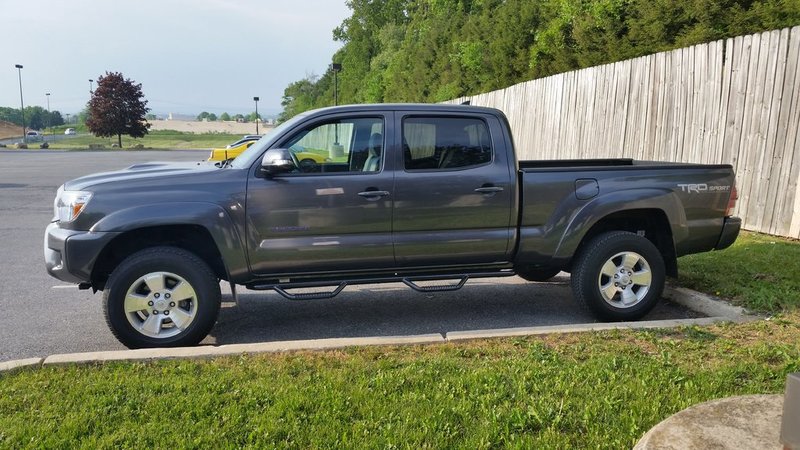

    I love the ride after installing 5100's all the way around. Front set to 1.75 and a 1" Toytec block in the rear. Anyone who has driven in PA know the roads suck. I glide over the potholes now. 20150517_180212.jpg
