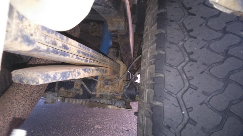

    So, not to thread jack, but while we are on the topic of leaf springs i have a question. Mine are, how you say, negative arched. Basically arched the opposite way than normal. Its not bad, i guess, but they are arched the wrong way. Is this a sign to replace? They have been this way for a while now. I can get pic's, but not till tomorrow. sorry op, glad to hear these guys helped diagnose your issue.

    absolutely dude, in fact at the point they lay flat with no load in the truck they are shot and need replacing but the OP springs are cheap to buy, ours are costly, like in the $400-$500 area for a pair. im amazed you have this issue with a prerunner, we have the heavier springs already so somebody must have seriously overloaded you truck to make the springs go like that. you sure they dint crack on you? sometimes they do that.

    God damn you tacoma world!!! Every time I get on here (like every 5 seconds) i find more shit i need to spend my money on!! Cool, thanks bro. Time to get a dealer quote! Back to you op!

    Ya, im aware of everything on my truck is 4wd minus 4wd! Good looking out though. Here is a pic of my springs. Yes i know i need new tires. Ive been having to commute my truck lately as i have a outstanding ticket, no money, and a blown cv axle on my commuter car. DSC_0046.jpg
    Let's hand this thread back to the op. I totally dicked him. Thanks for the links keakar.
