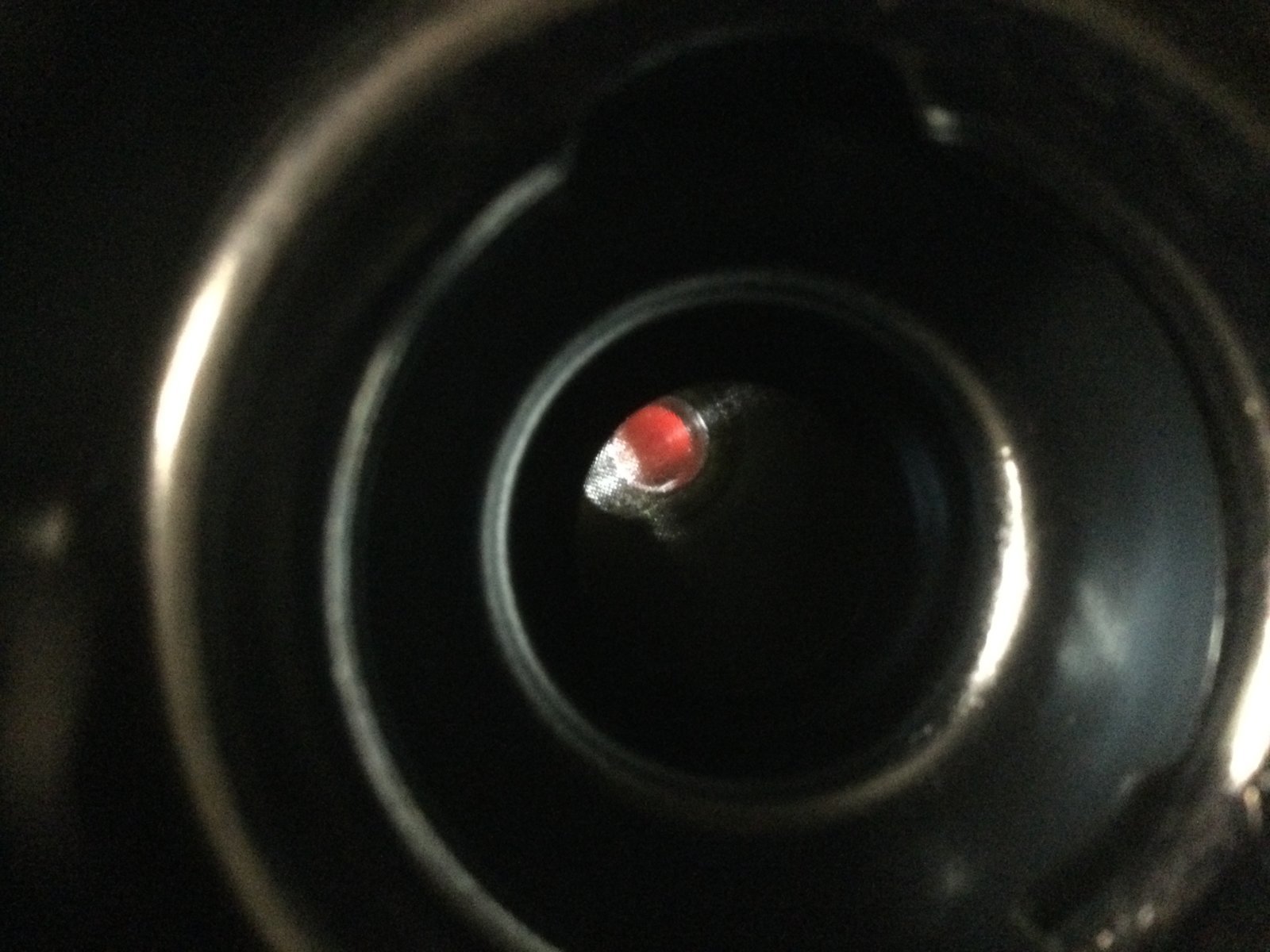

    So I have a new reservoir sitting on the shelf waiting for it to warm up to change! Super fine mesh brass screen. CB780CD2-6E94-40A8-B873-164A20D313B9.jpgCB780CD2-6E94-40A8-B873-164A20D313B9.jpg
