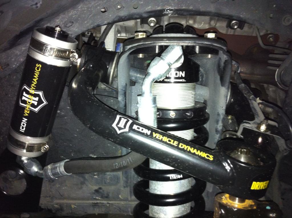

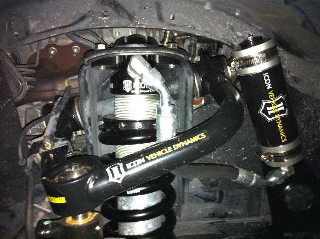

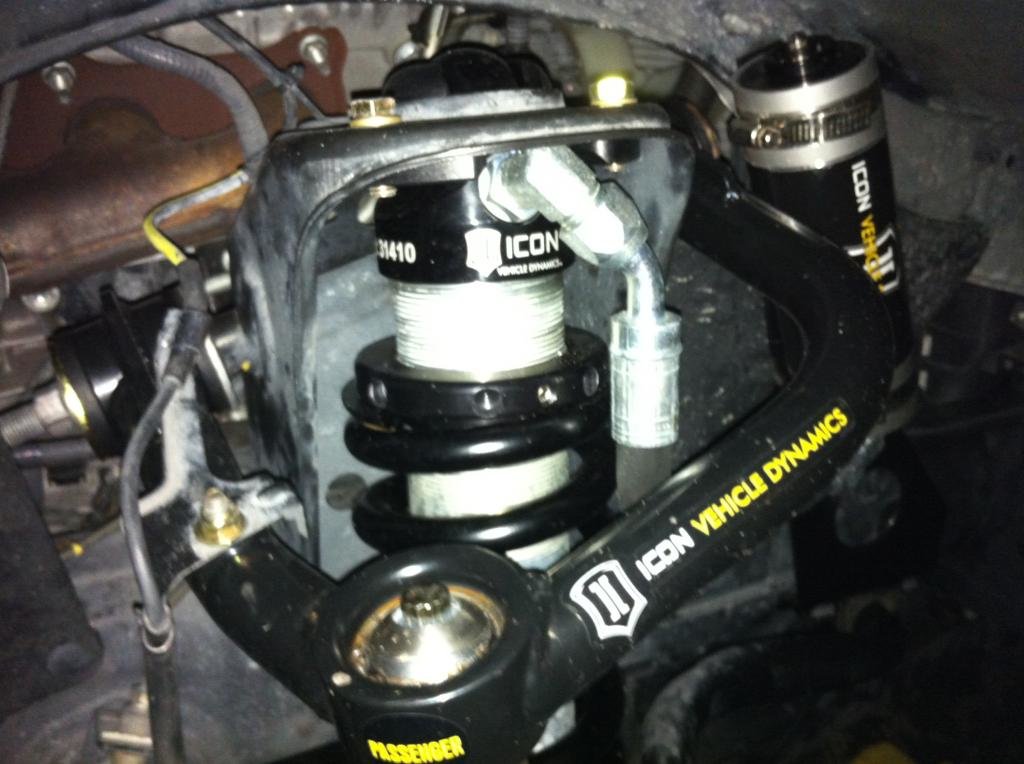

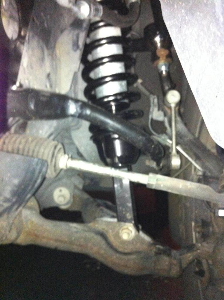

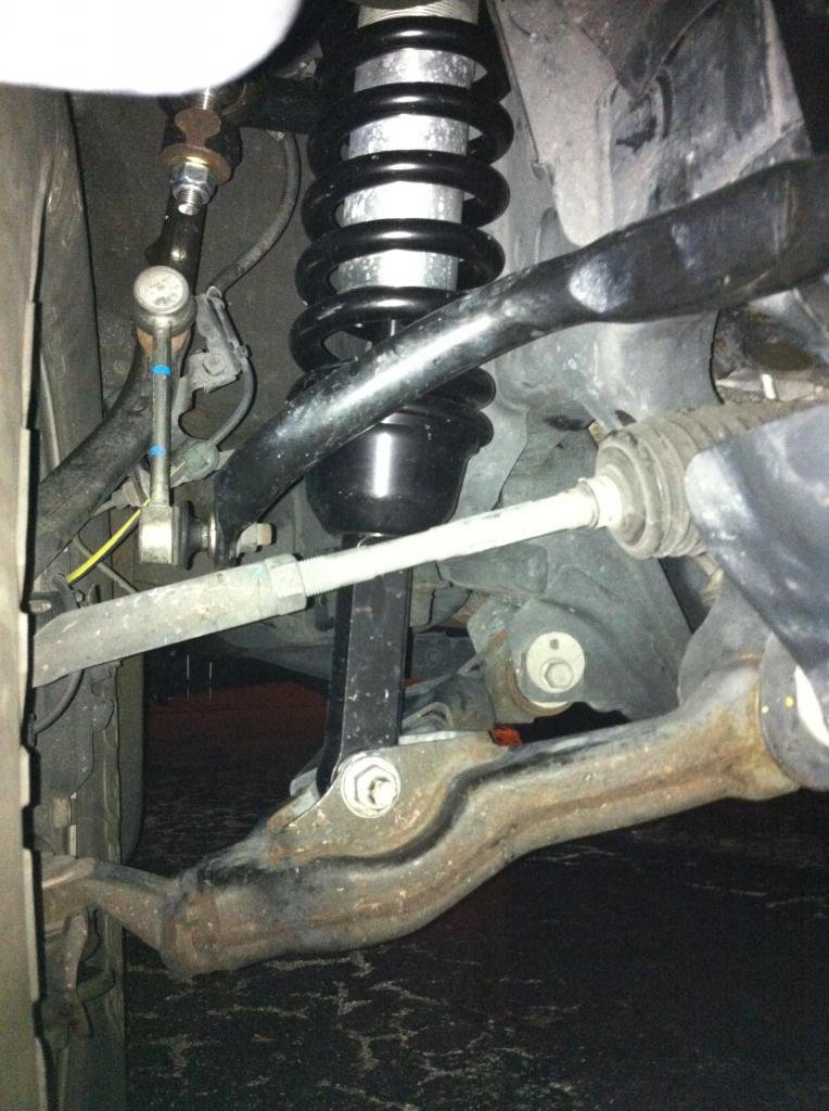

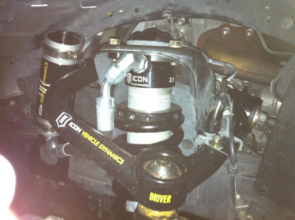

    Driver Side
    Passenger Side

  7. Aug 15, 2014 at 6:54 AM
    username
    username Fluffer
    Oct 15, 2010
    #44704
    6,064
    Pendleton, Or
    05 Taco with some crap welded to it
    mostly stock
    Looks good to me, the only thing I would look at is where the lower control arm bolts on to the spindle. You may not have even removed those bolts, but I think it's possible to put that piece on backwards. Other than that, it may be an unrelated steering rack failure. Steering racks are garbage on these trucks. Jack up the front end until the tires are off the ground and have someone steer it full left and full right and see what is going on.

  11. Aug 15, 2014 at 9:08 AM
    Large
    Large Red
    Sep 10, 2011
    #63268
    22,457
    Only thing I see it the cups for the uniballs have rust on them, other than that it looks pretty good.

  15. Aug 15, 2014 at 9:36 AM
    Mitch
    Mitch Somebody call for a Wambulance?
    Jun 27, 2011
    #58964
    5,629
    Mitch
    Spokane, WA
    2007 Access Cab SR5 4x4
    Lights, Siren, Drugs, Needles, Electricity
    Did you buy this kit new or used? Those uniballs look like crap
