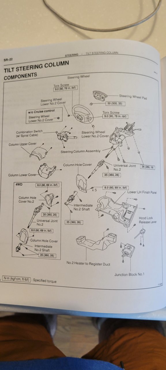

    I have been dealing with really stiff steering for a while now. The wheel turns easy at high speeds but it was really difficult to turn at 90 degree intervals at low speeds.
    I did the power steering flush that @Timmah! posted here, and my fluid was really bad. The mesh screen was pretty clean. Afterwards my steering was still just as stiff.
    I then pulled out my FSM and reviewed the tilt steering column components and found a fix. My steering is now really clean, infact I may have added a bit of slop so be careful on over greasing. Warning, this fix has a potential to mess up your wheel alignment, it could potentially permalock your steering wheel resulting in a airbag sending to fix if done incorrectly. Screw up could result in your steering wheel locking up while driving aka resulting in a crash. I'm not 100% certain on these details, I cowboyed through this so don't be like me, read through the airbag section of the "restraint system" before you go near this. If you end up yanking on your wheel wrong during this it can result in serious damage. If you separate this U joint incorrectly it could result in faulty steering. If you over grease it or break it it could result in faulty steering. Do this at your own risk.

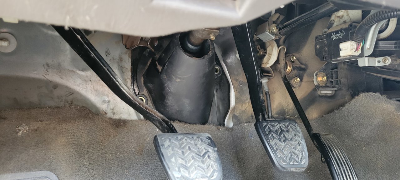

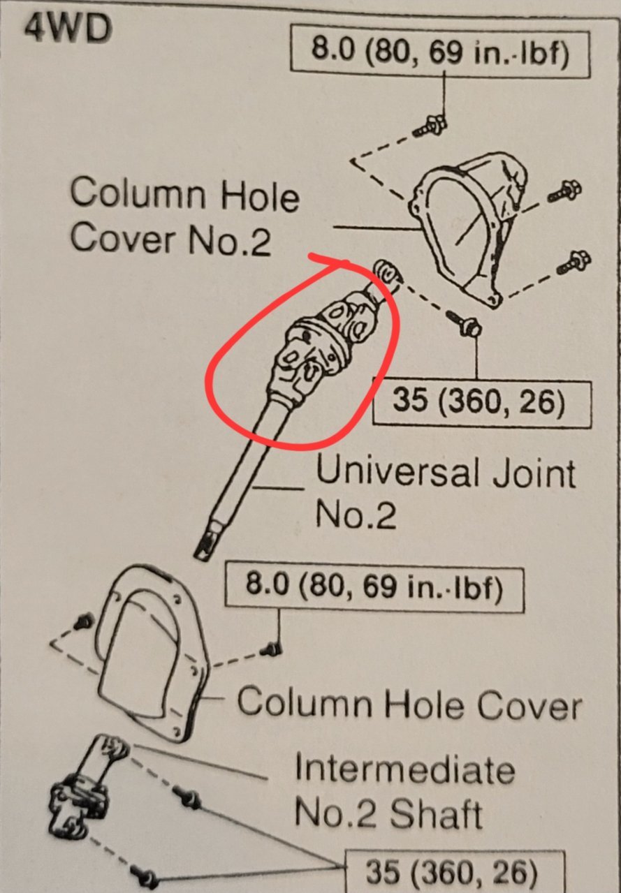

    There is a double knuckle that's part of the "Universal Joint No.2" that is attached between the steering column assembly and the "intermediate shaft no. 2" (intermediate shaft No.2 is the rubber joint they attaches to the steering rack and steering column shaft)
    The "Universal Joint No.2" is the issue, and the FSM does not explain how to clean or fix it. It is behind a plastic cowl with 4x10mm nuts at your feet where the steering column goes into the firewall. Before you open the universal joint, watch the first video posted. There ia a "nipple" or round elbow on each mating side of the universal joint that mate to a free spinning plastic piece in-between them. If those two "nipples" or "elbows" don't re-engage into this plastic piece your wheel will eventually lock up at some point and if you're on the road that would be possibly fatal.

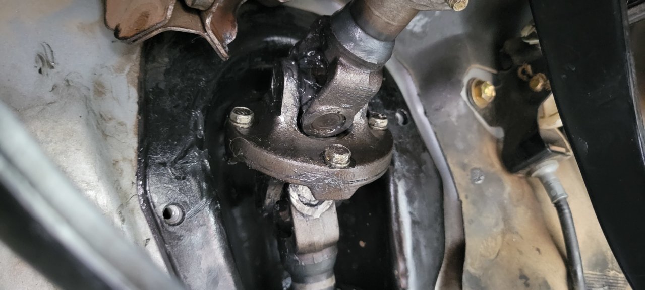

    Try greasing the universal joint before opening it. Use a greasless penetrating lube like LPS that will move dirt, and then some auto grease. Don't open it unless you know precisely how to reassemble it
    If exterior greasing fails, you'll want to pop the "Universal Joint No.2" mating face open, it has 4x10mm bolts (I don't know the torque spec it's not given, I went with 26ftlbs) and put some grease in-between the mating face as deep as you can, and then on either side of the elbows of the joint. I first hit it with some greasless lubricant like LPS, then automotive grease. I don't suggest WD-40 because it doesn't push out dirt and collects dirt. I was not able to completely remove the assembly it yet but I'm working on a way to do so to make sure it's 100% functioning.
    Here's a video of what it looks like fully removed: https://youtu.be/XirwbszshJg
    If you want to really remove it, I'm not 100% certain on how to do that and I might work on that this weekend. To begin removing it you probably want to take the "intermediate no.2 shaft" off the steering rack.
    You can see Tim starting to remove the "Intermediate No. 2 shaft" here at 22 minutes in his steering rack video. If you keep watching he will show how to disconnect it:
    https://youtu.be/wZoRP5ogrK0#t=22m0s
    Attached are the FSM images of the 4x4 shaft assembly and images of mine.
    If anyone has a better way of removing, opening and cleaning this part please let us know. If anything I've said here seems wrong or dangerous let us know.
