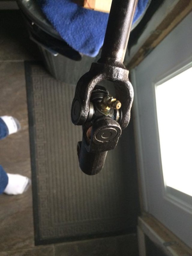

    Here are two pictures of the Intermediate Steering Shaft #2 taken from drivers side looking past tire (with tire turned as far left as possible) on my 2008 Tacoma

    Looking at the universal joint begs the question. Does Toyota make anything that doesn't rust out?

    I was glad to find this post. Even if it is an older one. I was nervous since my tacoma was having issue. Nice power steering to almost nothing. Stiff spots in the steering. I will be spraying the daylights out of that joint. I'm surprised there isn't a zerk fitting somewhere on that jount. I have seen joints this size with grease fittings. Oh well.
