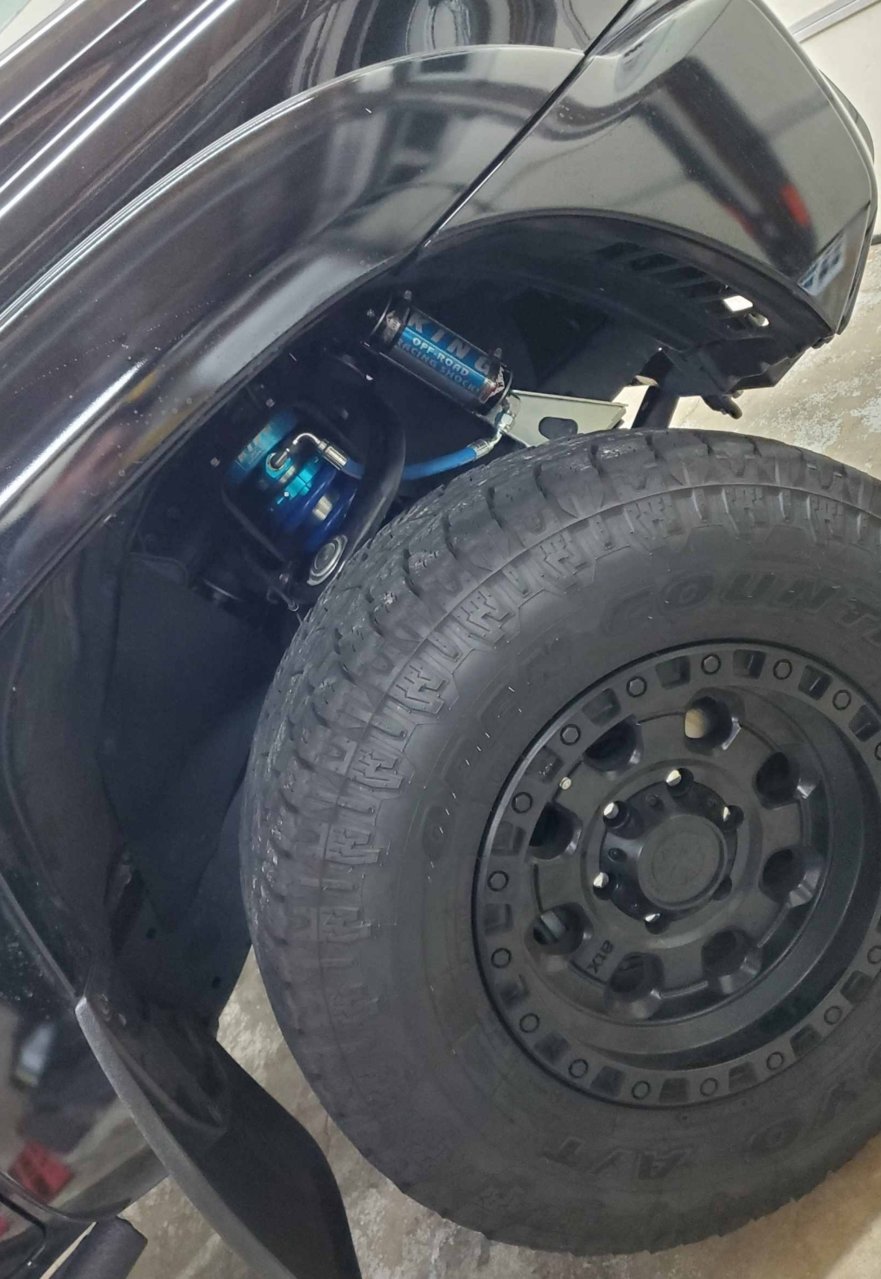

    Just took measurements and Im sitting at around 22.5in front and 24in rear. Measured hub to fender.

    Also, @fatfurious2 and @kylehorvath, Upon jacking the front end up from the front jack point, Im able to get over 2.5 inchs of downtravel. So much downtravel that any more and I will need aftermarket UCAs. Im sure uptravel is equally good. So therein my issue seems to be spring rate. Im going to see if I can source some 500lb eibach coils. Or maybe 550. I believe they are 14in springs but im gonna confirm with accutune tomorrow.

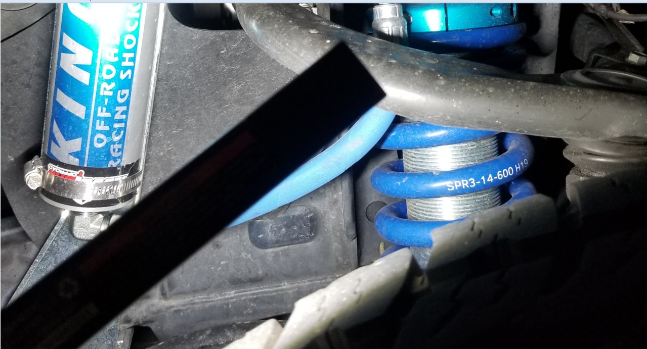

    There should be some numbers printed on the springs. If there is a 14, that will tell you if they are 14in, and if there is 600, then thats the rate. Something like 3.0060014
    Ive never heard of going that low of a spring rate on Kings. But its your truck, do what you want to it. Maybe @AccuTune Offroad can chime in with what they actually did

    I know that sounds pretty low. Maybe 550lbs would be better. I dont wheel it but its driven over some shit roads here. Also thanks for that tip of checking the print on the springs, didnt even think they had the length printed. They are in fact 14in 600lbs34532.jpg
