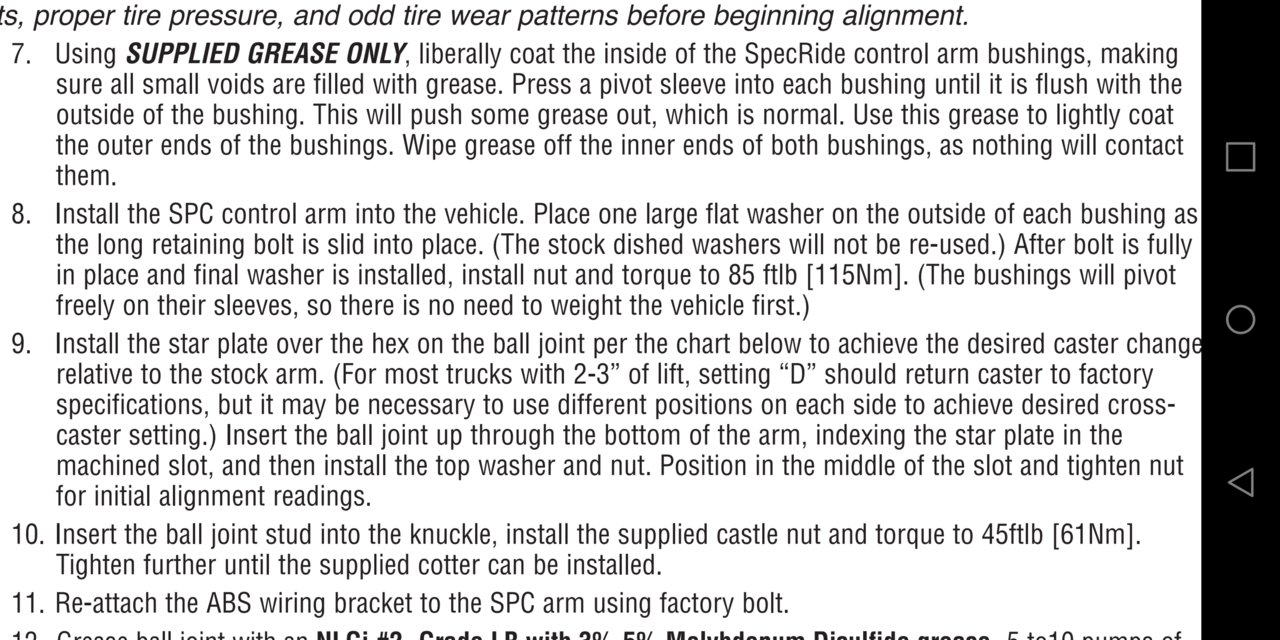

    Per instructions provided by SPC, this is not required. Part 8 in photo below. I did however take your advice and torque with vehicle weight.Screenshot_2018-05-27-15-12-31.jpg
