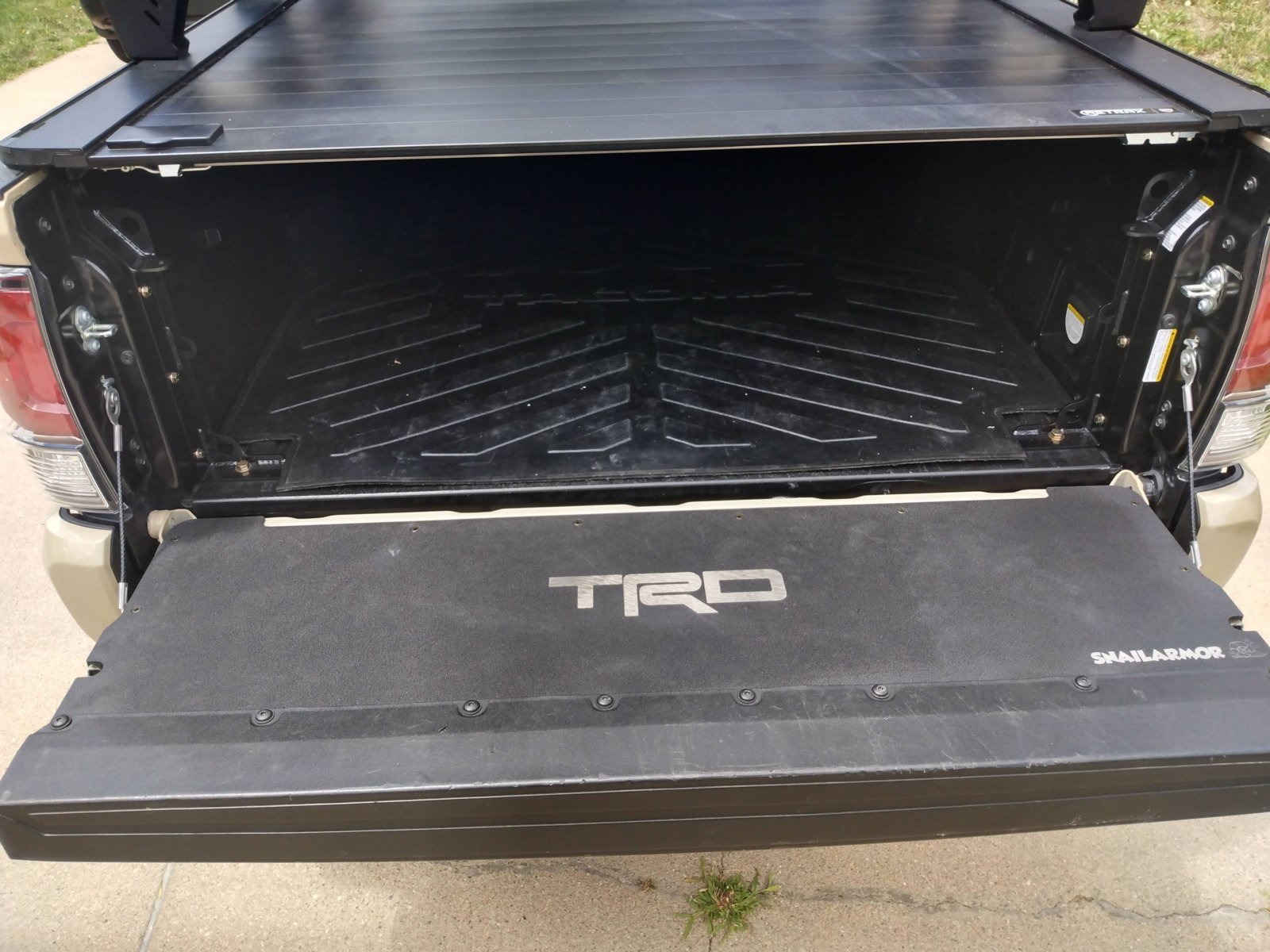

    I picked up a set of TC stiffeners because I carry a lot of weight on my bed rack, a lot of stiff in the bed, and will be topping it all off with kayaks as well.
    Great product and gave me quite a few more tie downs.
    What I didn't expect, is that they corrected the drivers side of my bed that was actually splayed out by a quarter inch or more, and got me back to 90deg on both sides.
    Easy to install and worked with my OEM bed rug.

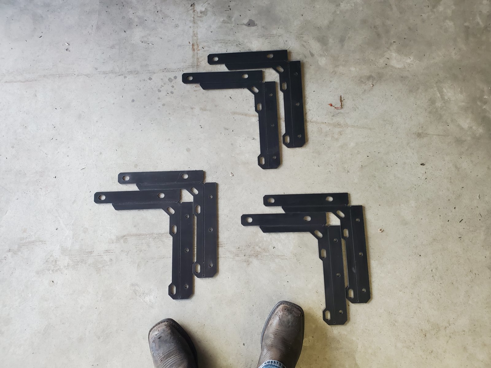

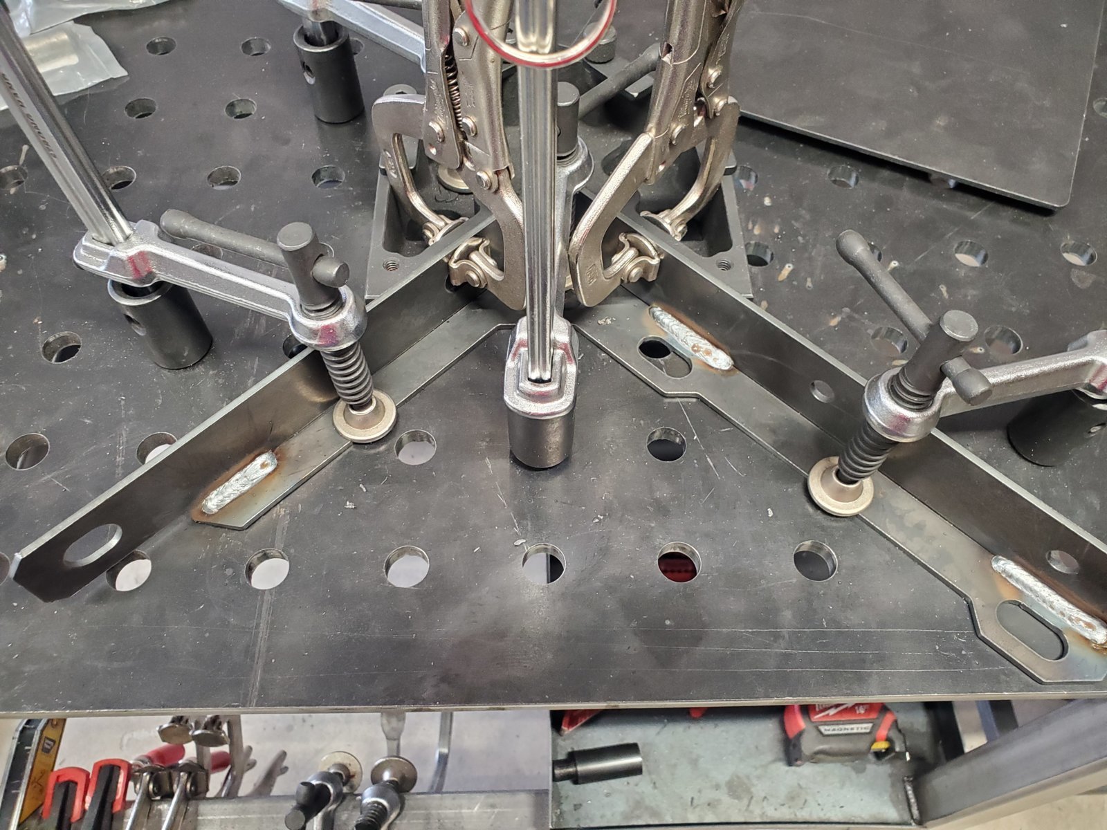

    Funny you ask, I cut an extra one just a few days ago
    Here's my thread - https://www.tacomaworld.com/threads/kwik-fab-stiffies.804205/
    Tons of pics as you go through the pages, and many sold
    I'm just not offering them as a welded set anymore, but found you can weld up the insides and they'll work perfectly fine the same way as welding the outside

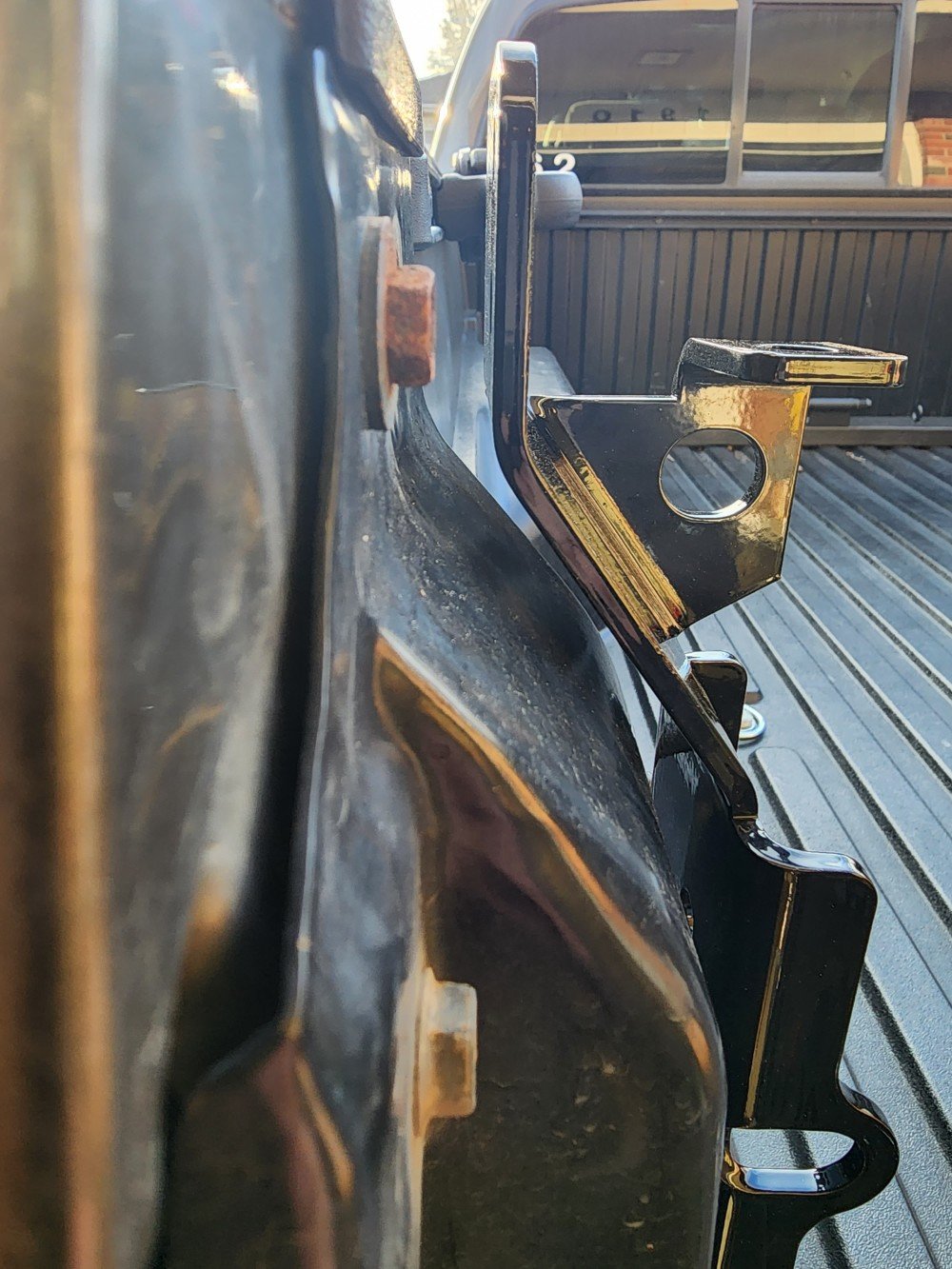

    Installed 1320 Performance stiffeners today, and this is how far off the driver's side was beforehand. Bottom was flat on the bed at the time of the pic. After it was fully bolted in, it's nice and square. Half the time, I have a ~200lb fiberglass camper shell on top. Whatever brand you go with, just get some before it's too late.
