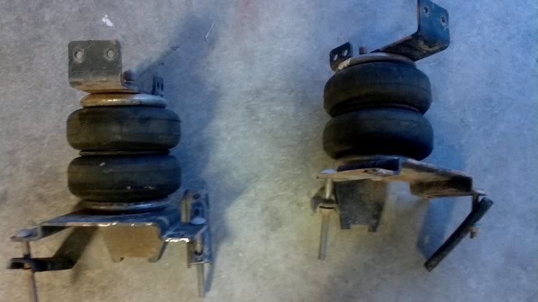

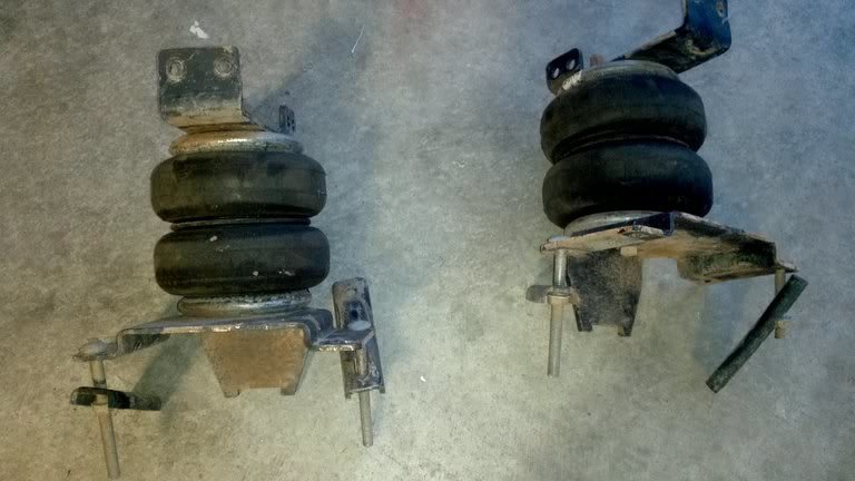

    Firestone Ride-rite air bags. Mounting hardware missing 4 of the required 8 carriage bolts w/ nuts. All other bolts are present.
    SPECS:
    Firestone double convoluted air spring bellows designed for up to 100 PSI. 268C STYLE 1/4" NPT
    • Compressed Height: 2.80"; Extended Height: 7.00"
    • Ride Height:4.50" - 5.50"; Max. Diameter: 6.40"

    It definetly smooths the ride out as long as you dont keep more than 5-8 psi in them when unloaded... I could pull a 14ft enclosed dual axle trailer and not sag any in the rear with these...
