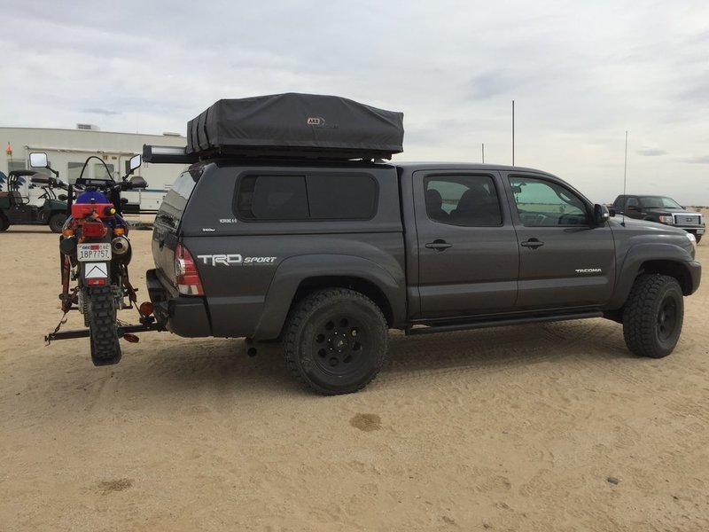

    Not THAT much. I don't use it on trails only for transportation and essentially use the dual sport for a means of transportation once the rig and RTT are set up - for extended stay trips.

    Thanks, I guess I should've been more specific, sticking out as in beyond the sides of your truck.? Like if you're looking at it from behind.
