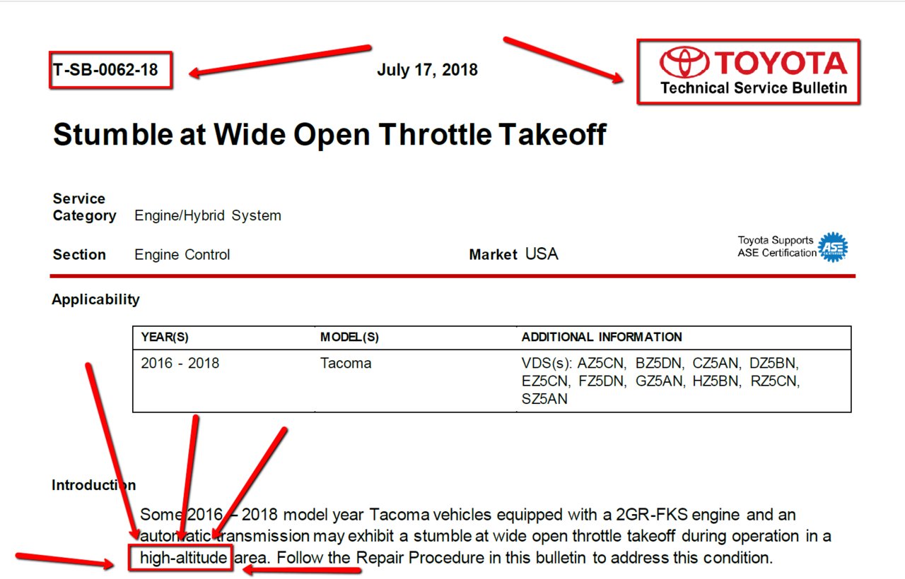

    That TSB is not "high elevation nor high altitude".
    But after my '17 stumbled 3 times trying to cross Federal, I got my dealer, Pueblo Toyota to perform the 00-62-18 TSB and it is a different driving truck since.

    Well, Ill be a horn swaggled pig in shit! I never saw that document before!

    You mean the document that was in the link you said wasn't high altitude?

    I never saw the Toyota TSB letter. I only knew that the TSB as for stumbles.
