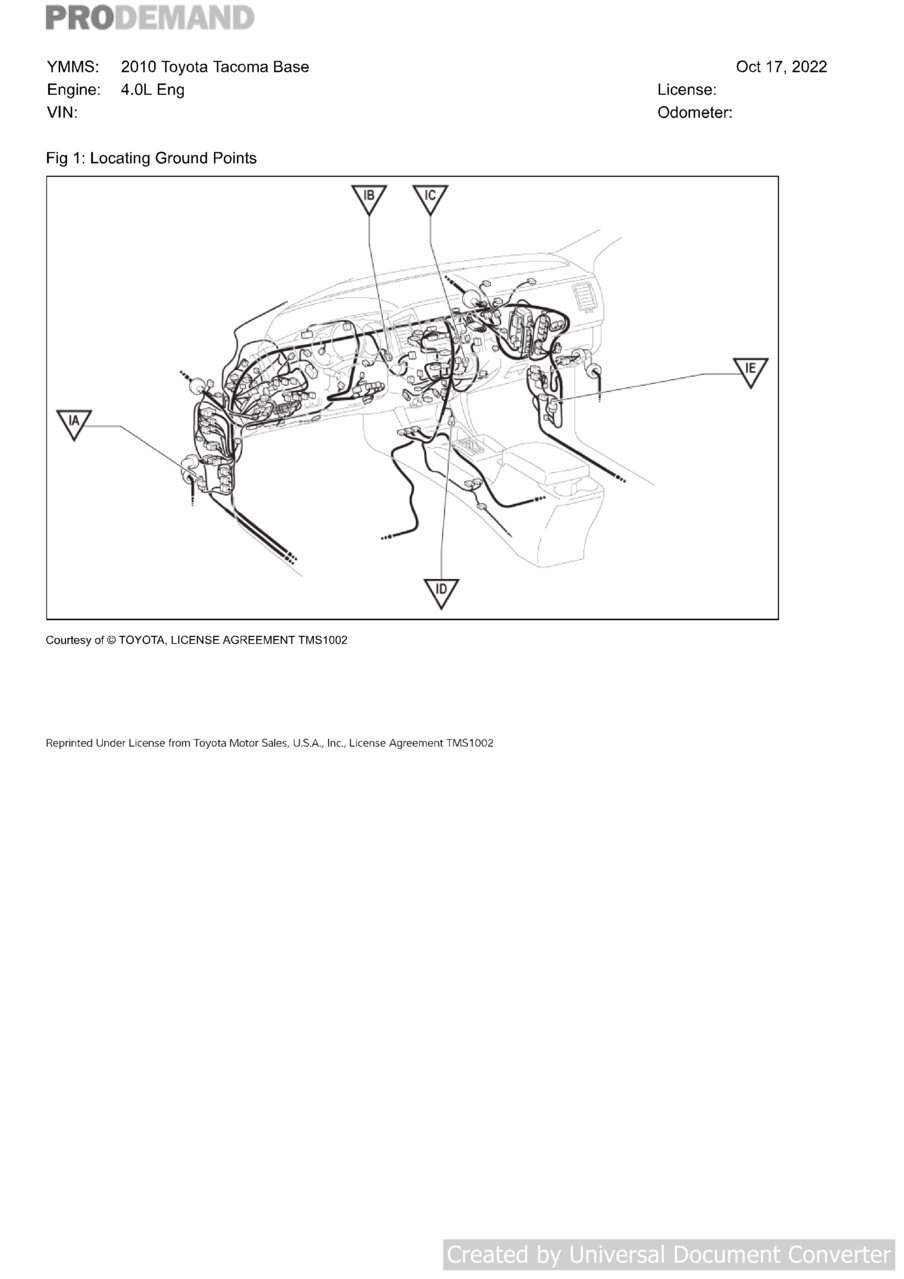

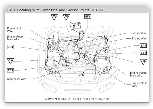

    The heavy gauge white wire should have constant battery power, the White/Black wire should have full time ground, and the Blue/White wire should have power with the key in the run position.
    Here are the wiring diagrams, PCM pinouts, and Ground Locations for the 2.7L
    BassAckwards and TnShooter like this.

    Ok so the heavy gauge wire has 12.8 when KO when runnibg 14.2 so there is adequate power there, for the smaller plug im not getting readings on any wire except the r/g wire with KO and with it running nothing but 2.07 from the same r/g wire. If i try to measure power through the unit with the big harness plug in and the smaller gauge one unplugged there seems to be 0 power through the unit
