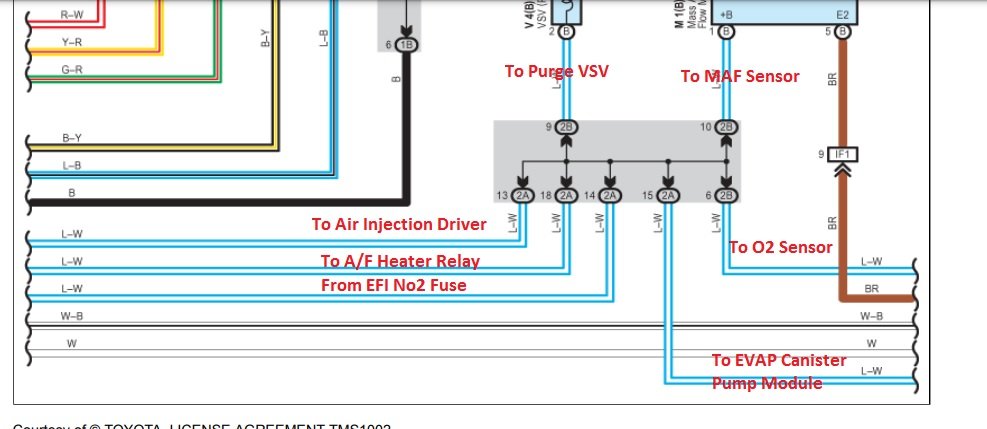

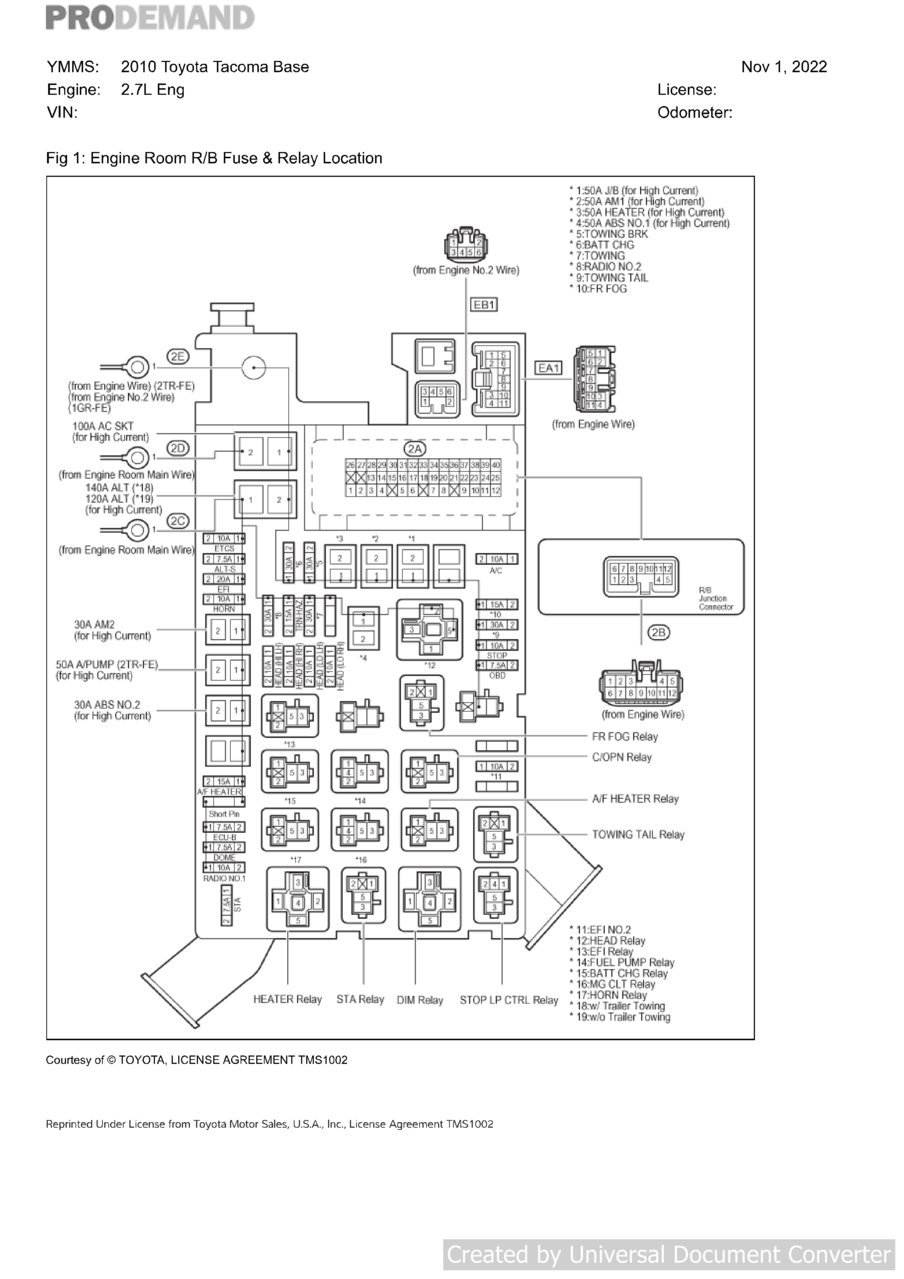

    Ok looks like you have a problem at the 2A junction connector in the engine bay fuse box or that wire is open between the box and the driver, power to the Blue/White wire at the pump comes from Pin 13 of that connector.

    #387891

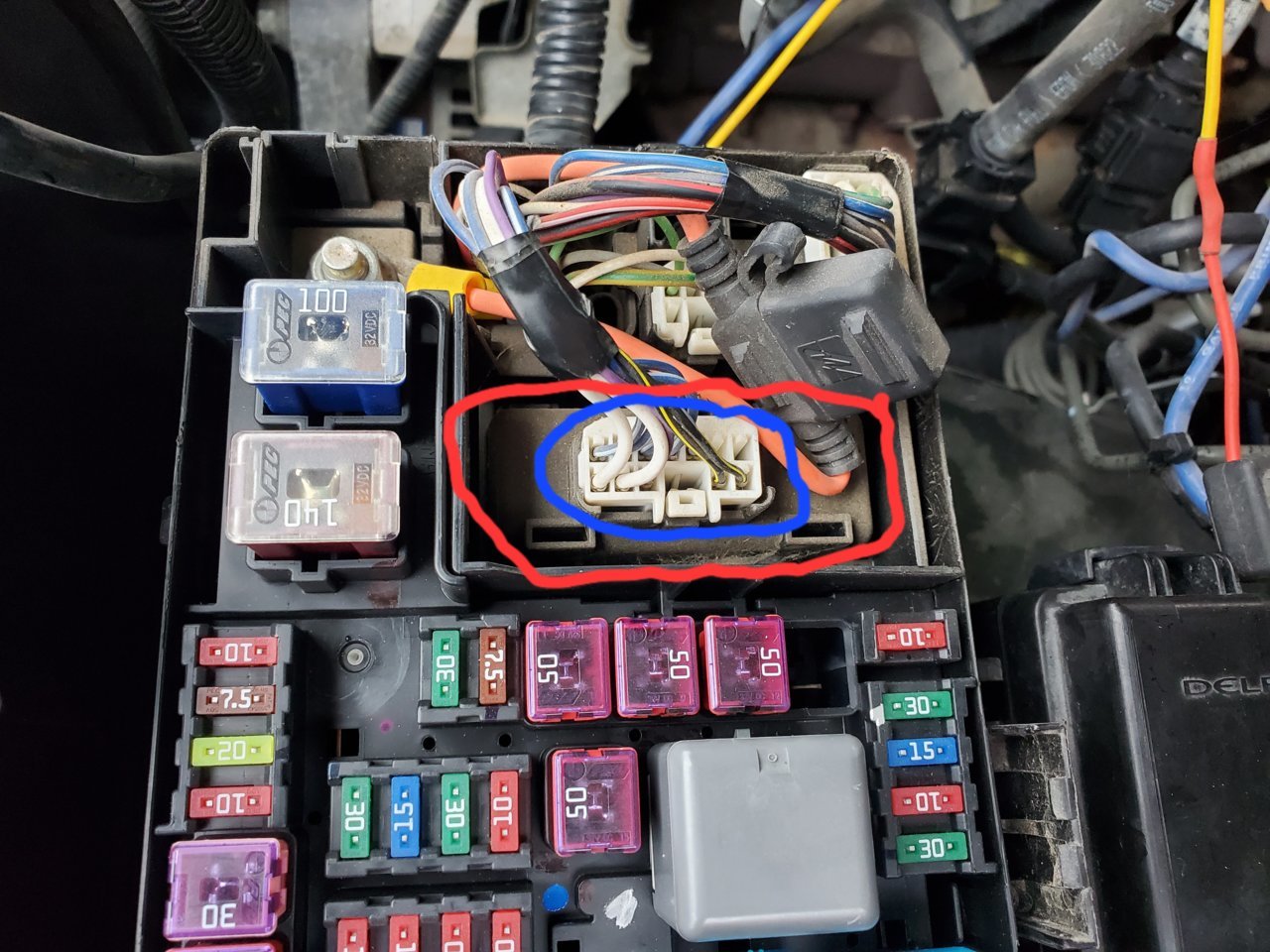

    The junction box and connector I metioned is under the engine bay fuse box (circled in red below).
    You could unplug connector 2B (circled in blue) and look in there for corrosion but 2A is on the bottom side.

    How do i unplug it remove the 4 10mm?

    I'm not exactly sure how to get to 2A as I've never had the engine room fuse box apart but I'd unplug 2B first and look in there for corrosion.

    I did that absolutely 0 corrosion and everything looks perfect even still paint marker marks on some of the hookups

    Check Pin6 (Blue/White) of connector 2B for power with the key on. That feeds the heater circuit for the O2 Sensor, I suspect you may not have power there either since you have a heater code.

    What about pins 9 & 10 of 2B?

    There's got to be a problem under the fuse box then with a broken/corroded wire or a problem in the RB junction then, that would explain most of your codes as that feeds alot of the sensors.
    I'd say it's time to pull up the fuse box and look under it for rodent damage and corroded wires.

    I mean if you have confirmed voltage is good at the fuse but there's no voltage coming out of the 2B connector on any of the Blue/White wires then the problem has to be under the box between the fuse and connector 2B.
