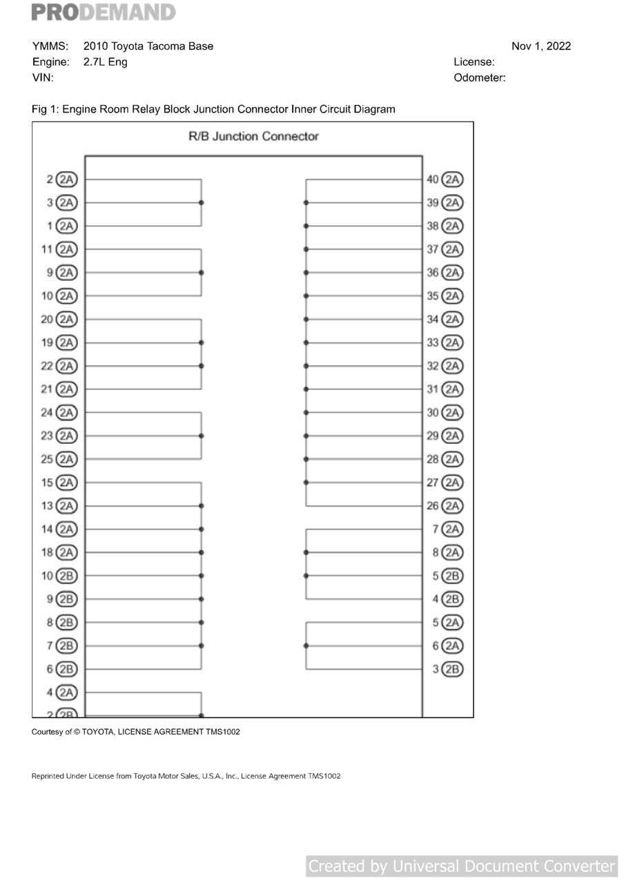

    Ah I see, I wonder if there's something going on in that junction. or with the wire coming from the EFI no 2 fuse.
    Maybe pull the EFI No2 fuse just to be sure it doesn't have a burnt or corroded pin.
    Here's the internal schematic of the 2A connector/junction.

    Efi fuse has no burning or corrosion and honestly im not sure if there is a wiring issue im getting power now everywhere i should im gonna try and see if i can clear the codes if i cant ig ill fix my other car and then send my truck to atlanta to be fixed
