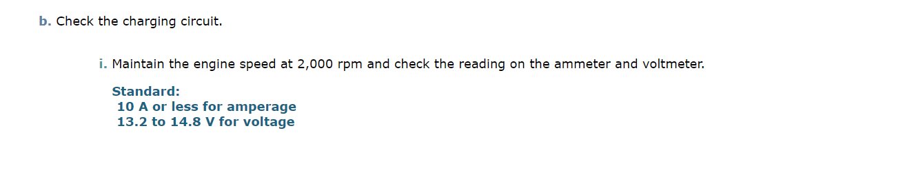

    I think you are fine.
    Toyota doesn't want you to check the charging system at idle.
    They spec it at 2,000 RPM

    That doesn't sound like a charging system issue.
    Clean the MAF and TB as suggested above. See if that helps.
