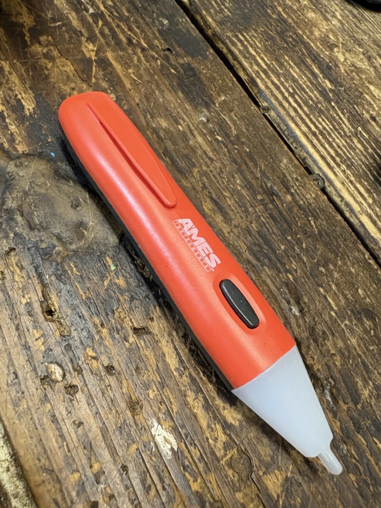

    how do you test to see if you have a power pulse to injector? multimeter?
  18. Oct 9, 2024 at 6:51 PM
    #18
    ControlCar
    ControlCar My Moto: Help & Learn…period.
    Jul 22, 2023
    #429578
    3,611
    Steven
    Sugar Land TX
    1996 Taco 2.4L 2wd Automatic
    Clock Volt meter/LSPV Delete/Hyundai 16’s/FP gauge/after 9months of wrenching ZERO oil leaks
    I have used this with success
    Unsure my dizzy was getting power….showed getting power
    Non contact voltage tester
    Like $5 at harbor freight
