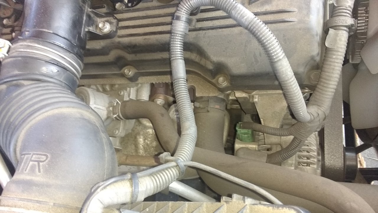

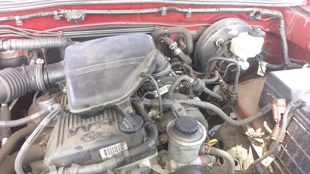

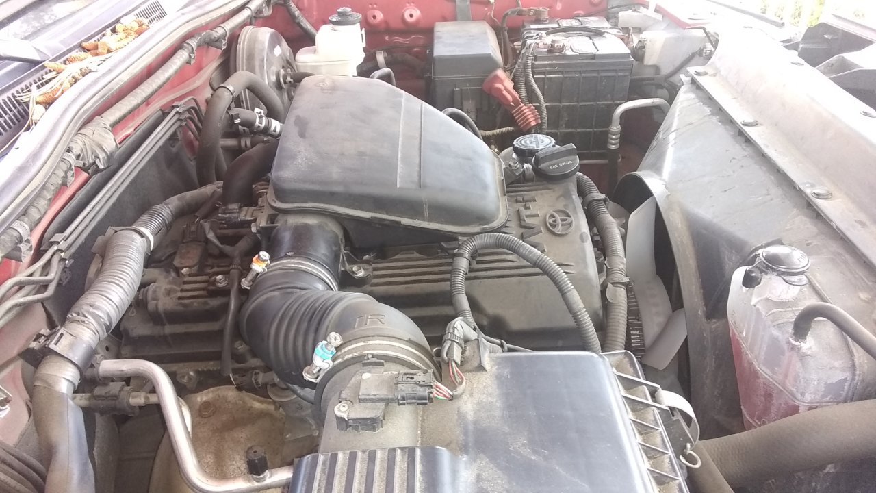

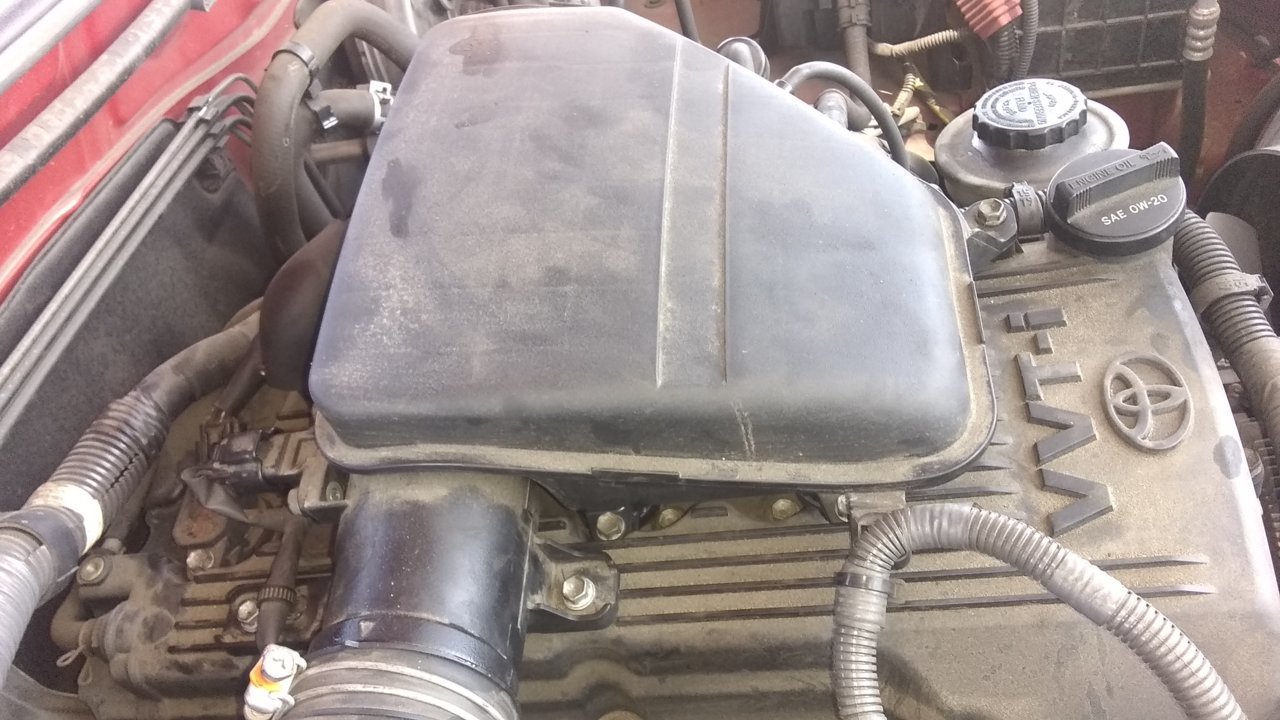

    Standing on the passenger side can you snap a pic of the engine and upload it, please.

  10. Apr 19, 2023 at 12:40 PM

    I diagnosed a truck like this with a 4.0 once with the same kind of code. You need to have him check out that fuel pump and really check it well. As in graph out the short term and long term fuel trim for a while and see if there are any major deviations going lean and then also have him hook a fuel pressure gauge all the while and really watch that thing good while it's idling or whenever it acts up the most.
    The truck that I inspected had a few scorched fuel injectors due to the fuel pump failing, sending it lean under the most unpredictable times. It was very difficult to find the cause of his symptoms but after some long term testing I found what I did and he walked away happy that his truck was good to go in the end.
    Given that these later gen 2nd gens are documented and known to have real pieces of trash fuel pumps, and given your code of the air fuel ratio imbalance... Yeah, that's the route I'd lean into.
    If that fares out fine after thorough and in depth testing, valves or head gasket.
