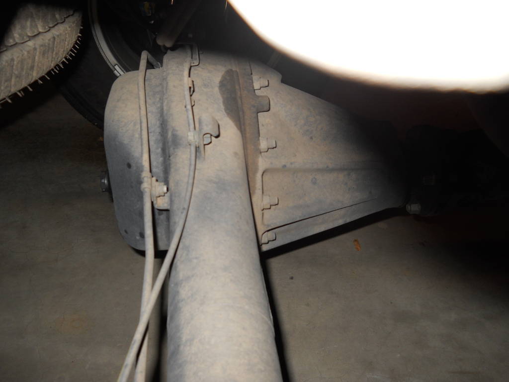

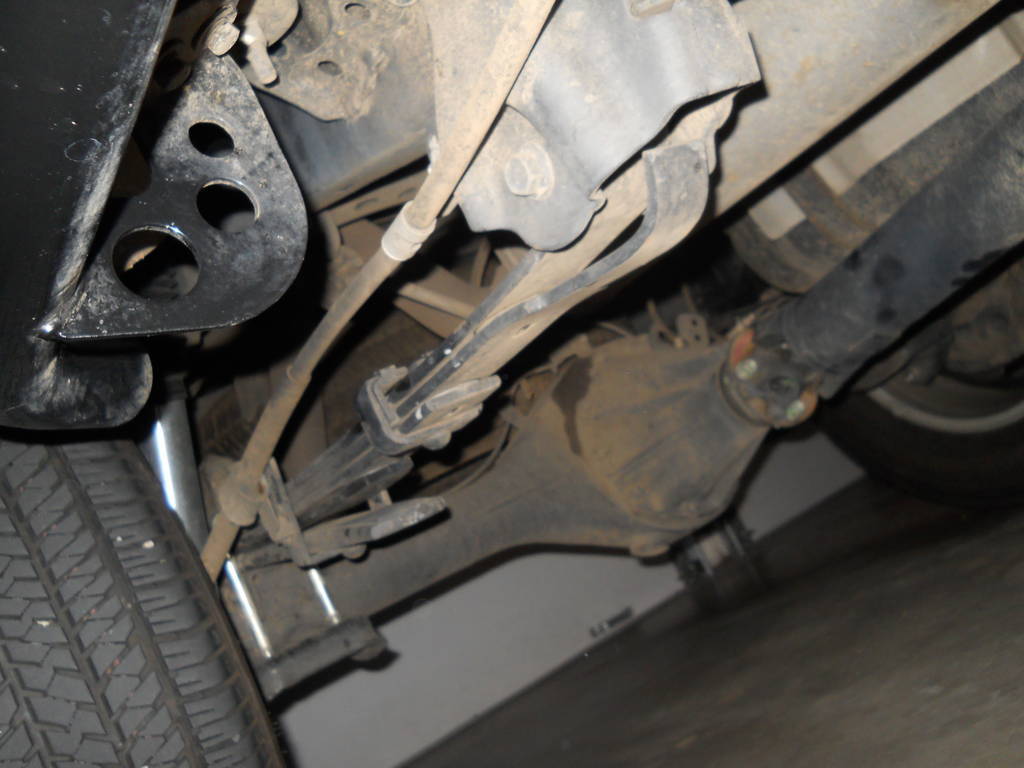

    Okay so a couple months ago I installed 5100's all around and set the front to 2.5", and the 1.5" ToyTec AAL(I Also have TSB), and a little after I noticed a vibration/shudder when accelerating from about 4-9mph..it goes away when in 4Hi, and if i accelerate really slowly, and let it catch the next gear at like 5mph, it doesn't do it...also, from a stop if you step on it real quick and it does it pretty bad and seems to lag alot or like i'm losing alot of power.
    So my truck went into the dealer yesterday for the 10k service, and I told them about it. They had a tech ride along with me, and it was kinda doin it, then he wanted to drive, and he started getting it to vibe/shudder a lot and he was feeling it. He said they would check the t-case and the diff/lsd fluids and all that, and then they'd look at the driveline angles cuz it's lifted. So they worked on it from 9am to 2:30, and couldn't fix it. They said they installed shims and un-installed then re-installed them and nothing could get it to stop. The lift was installed by les Schwab and the dealer told me to have them look. I also just got my tires rotated/balanced(fronts) by schwab, and i feel like the vibe died down a little? idk maybe not

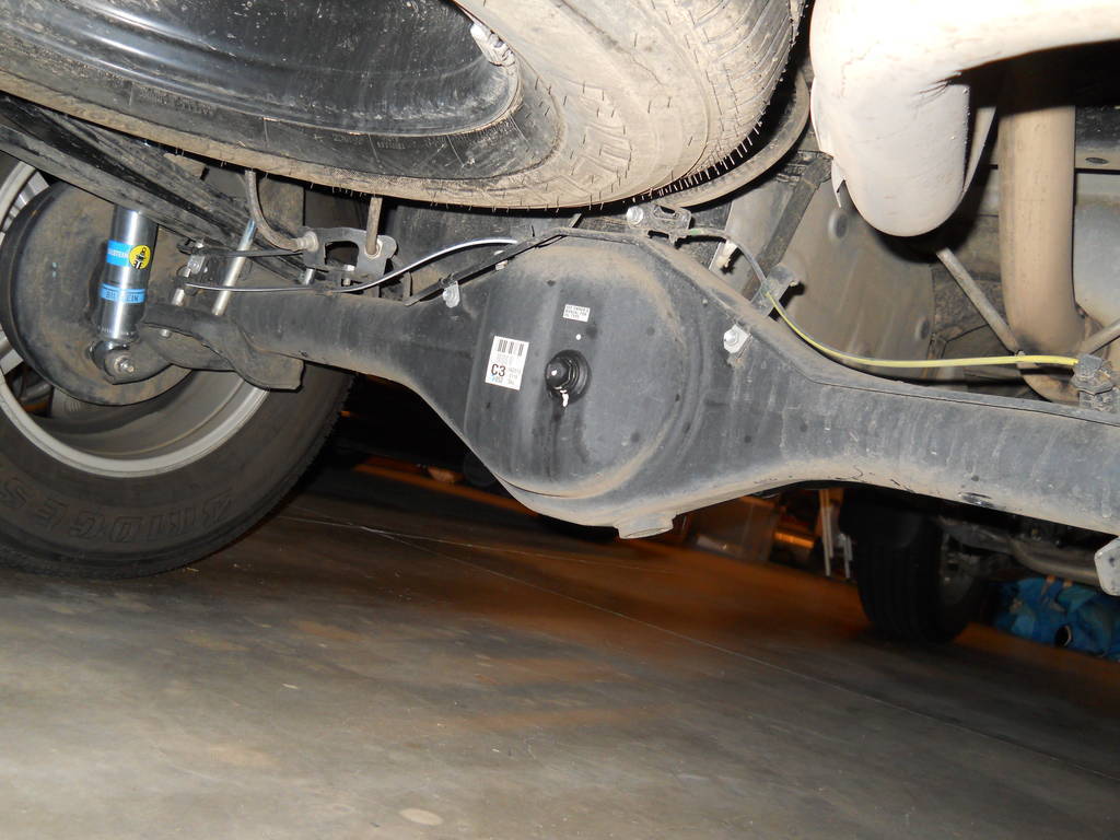

    Anyways, so now what do I do? Do you think the dealer really did put in axle shims? Should I try a CB drop? I'm just kinda stumped now, and I took some pictures, maybe you guys can tell me if you see anything installed wrong? or if my driveline angles are bad, or ANYTHING? cuz you guys know what to look for more than me.
    I'm out of town for the weekend, but next I'll have schwab check it out too, unless you guys know exactly what it could be..hope some of these pictures can help you guys, thanks in advance!

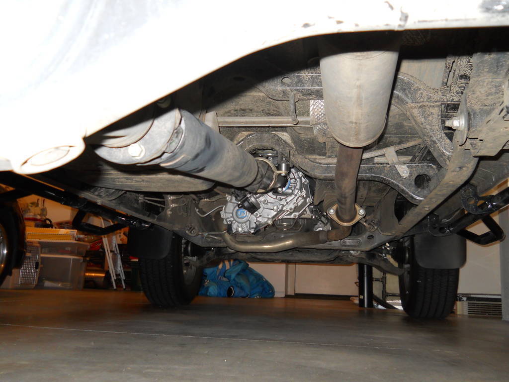

    What are the spacers you have on your CB now? Looks like about an inch conical spacer lowering it....sorry if I missed something, I am not sure what comes with the lift kit.

    Looking at your pictures I see silver spacers lowering your CB. Did you buy the truck used? I have a completely stock truck and dont have those. I would remove them. The
    CB should tuck into the notch in the cross member. I dont think you should need a drop for your mild lift...those spacers could be messing things up.

    Nope I bought the truck new and to my knowledge no CB drop has been installed. What are you saying is the 'spacer' that is on there?

    You def have some good sized spacers on each side of your cb bracket that holds it to the a frame. Those are large enough that I bet if you took the spacers out, those bolts would not fit. You sure a cb drop didn't come with the lift, or les schwab installed a cb drop without you knowing? Cuz that isn't stock. I had vibes on my first Gen at speed and tried a cb spacer bracket and it gave me a takeoff shudder so I obviously removed it.
    You would be one of the first that installed a lift and cured vibes by removing a cb drop haha, if that is the case

    ^^Okay I'll have Schwab look at that when I take it in. Is it the like cylinder looking thing that you guys say is a spacer? I bought the truck new and am 99% sure I didn't have any CB Drop installed, unless the dealer did it or something

    I'm surprised the dealer didn't notice that or question it... It's the 2 silver cylinders on either side of the CB mount. They space it down about an inch making the angle from the transfer case to the CB steeper and could be causing issues. It's doubtful the dealer would install one of those on a new truck plus it's nice and shiney like it was installed recently.

    Hmm well maybe the dealer installed that along with shims and forgot to take that out? I'm not sure, but I do feel like it wasn't there before.

    There are some tricks in this page: http://www.4crawler.com/4x4/CheapTricks/Driveline-101.shtml
    You'll have to measure you driveline angles to find the problem. It's best to split the difference on the angles. Ie. shim the rear axle and the carrier bearing to bring both half shafts as close to equal as possible.

    Okay so I'm finally home and I looked at the work order from the dealer, and they did say they installed a 1" spacer for the carrier bearing, so you guys were correct. The vibe is pretty slight now, so I think I can live with it, but is it bad on any parts? And is there anything I can do to totally cure it?
