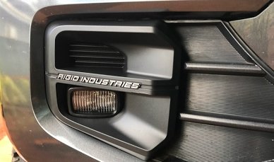

    These would look $weet:

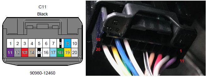

    The Tacoma has this (C11) connector behind the steering wheel covers.
    #8 is the Fog switch ground, #9 (BLUE) is the ground from the fog circuit. The steering stalk switch mates them to turn the fogs ON.

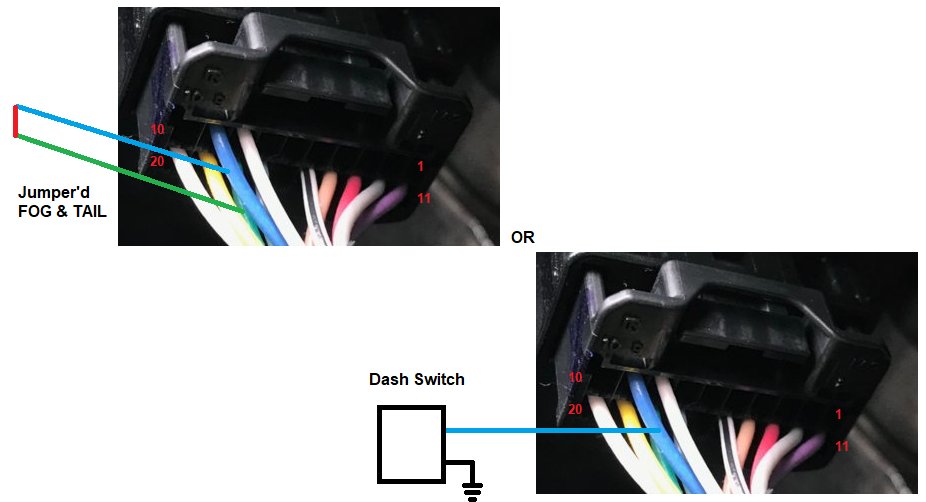

    Since you don't have the stalk with that feature, but the connector does, you can place a wire mating BLUE (FOG) with GREEN (TAIL/PARKING) so when you turn the stalk to TAIL the fogs turn ON.
    The FOGS would still turn OFF when High Beams are flashed or selected (like OEM)

    You could also choose to add a dash switch.
    This switch would get tap to the #9 (BLUE) then the other side of the added switch to a dash bolt for ground. And you'd have a way for turn the fogs ON or OFF, with no expensive stalk added.

    Those look good. I would like to see Toyota put a 2nd Rigid lamp in those bezels. 1 clear, and 1 yellow.
    More than 1 auxiliary lamp is illegal in some states, so that might not be something Toyota can do.
