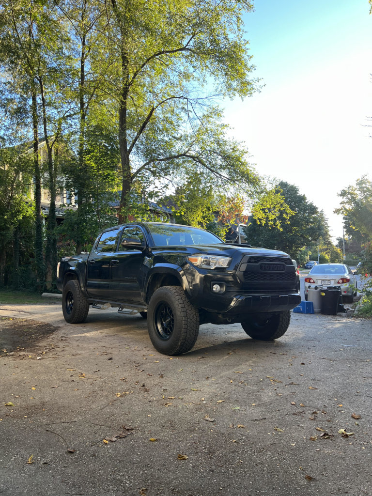

    Shortly after installing 285/70/17s on some Bilstein 1500s, I did some minor trimming in the wheel well, which dramatically improved what was a significant rubbing issue at the time. After less frequent but still continuous rubbing continued, I eventually took a heat gun to the fender liner and was able to mold back much of what was making contact with my tires. Since then, pavement driving has been almost perfect, with the occasional rub on turns onto steep driveways or other scenarios you could imagine.
    Still, I don't feel confident for this summer's trail season. I've yet to take this new setup off pavement, and I want to feel the same confidence that I did on the stock 265s.
    I'm wondering if anyone could share what they did with their fender liner. Third-party replacement, further trimming or heat gun adjustment, removal altogether? Whatever you got!
    I want the wheel well to look as OEM as possible while giving me close to, if not 100%, confidence in its clearance.

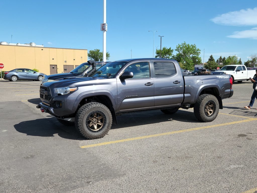

  6. Jun 16, 2025 at 3:39 PM
    Veet-88
    Veet-88 Well-Known Member
    May 21, 2015
    #155792
    1,670
    18 Tacoma DCLB sport
    Caster will be hardly visible it just shifts the wheel slightly forward in the wheel well.
    That's a 17x9 +1 285/70r17 and the high caster alignment
