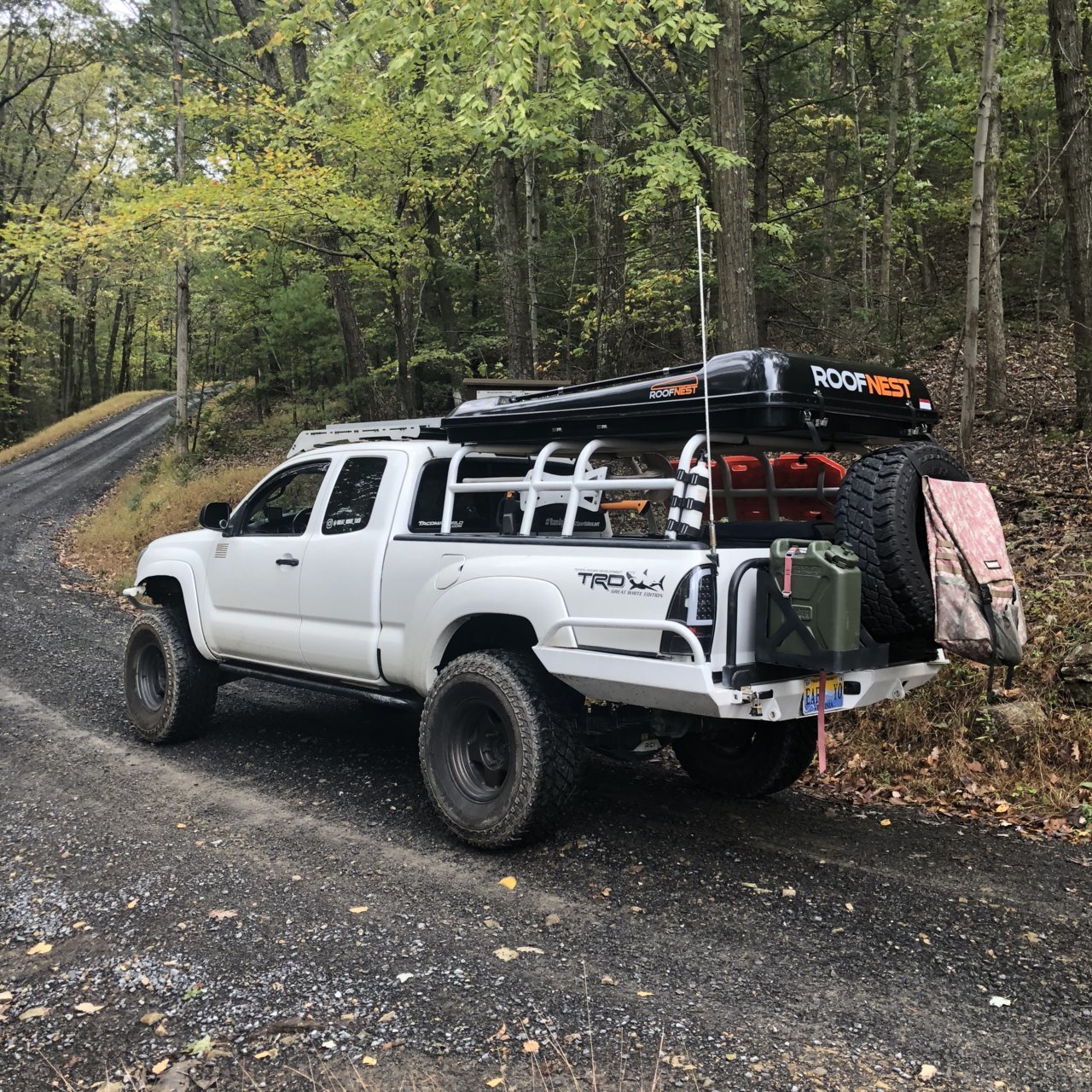

    9,252
    Alaska

    Now I have Dakar HD with the AAL. I have a hc rear bumper, swingout with 35, bedslide, bed rack, rtt - as daily, not even loaded for a trip.
    These are my guesses on weights:
    35 - 100
    Bed rack - 120
    Rear bumper - 250
    Bedslide - 120
    I know the rtt is 140.
