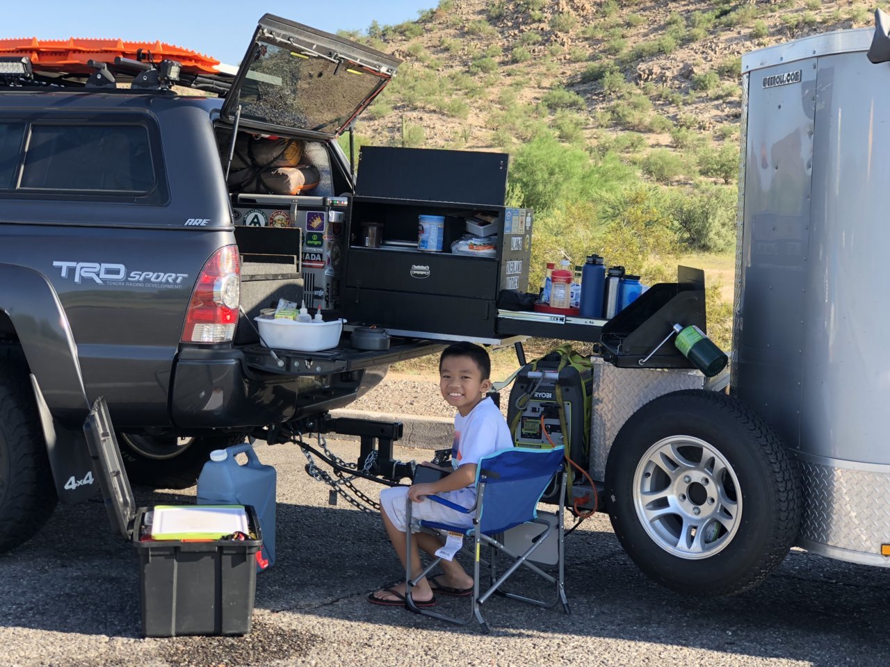

    Nice family camping pic. If you're worried about weight, I'd go with solar for power instead of the heavy and loud generator. I got my setup super cheap: 100w solar panel off Amazon and 35aH AGM battery from Harbor freight, runs the heater all night and interior lights.

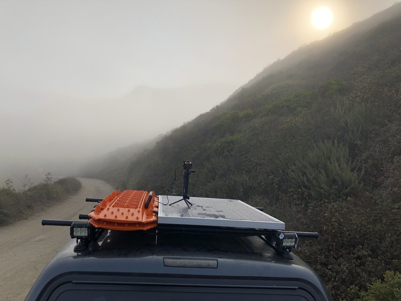

    I have solar as well mounted on top of my topper. Been running that for 3 years now E5772D89-6F14-4F71-BB04-D6647D44A88D.jpg

    Get rid of two batteries and add solar to the hood or rooftop.

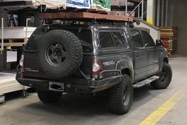

    The HD pack is just the regular pack with the OME AAL. I run 5-600 pounds in mine on a regular basis and it never sags below 3" unless I'm towing a loaded trailer in addition to the weight. One more AAL will make that pack incredibly beefy - you won't need 2. I had air bags before the leaf pack (with airbag cradle) and left the bags in when I installed the leafs. This might be a good option for you.
    Looking at your pic, it looks like you have more than 3" up front. That's concerning from a mechanical perspective. I have 3" of lift from suspension and a 1/2" body lift. You have a shit ton more room between the tire and fender. What's your measurement from center of hub to bottom of fender? 23" is a 3" lift.
    This^^
    If you're squatting a HD Dakar pack, you're caryring more weight than you should in a Taco and need to start beefing up other components.
