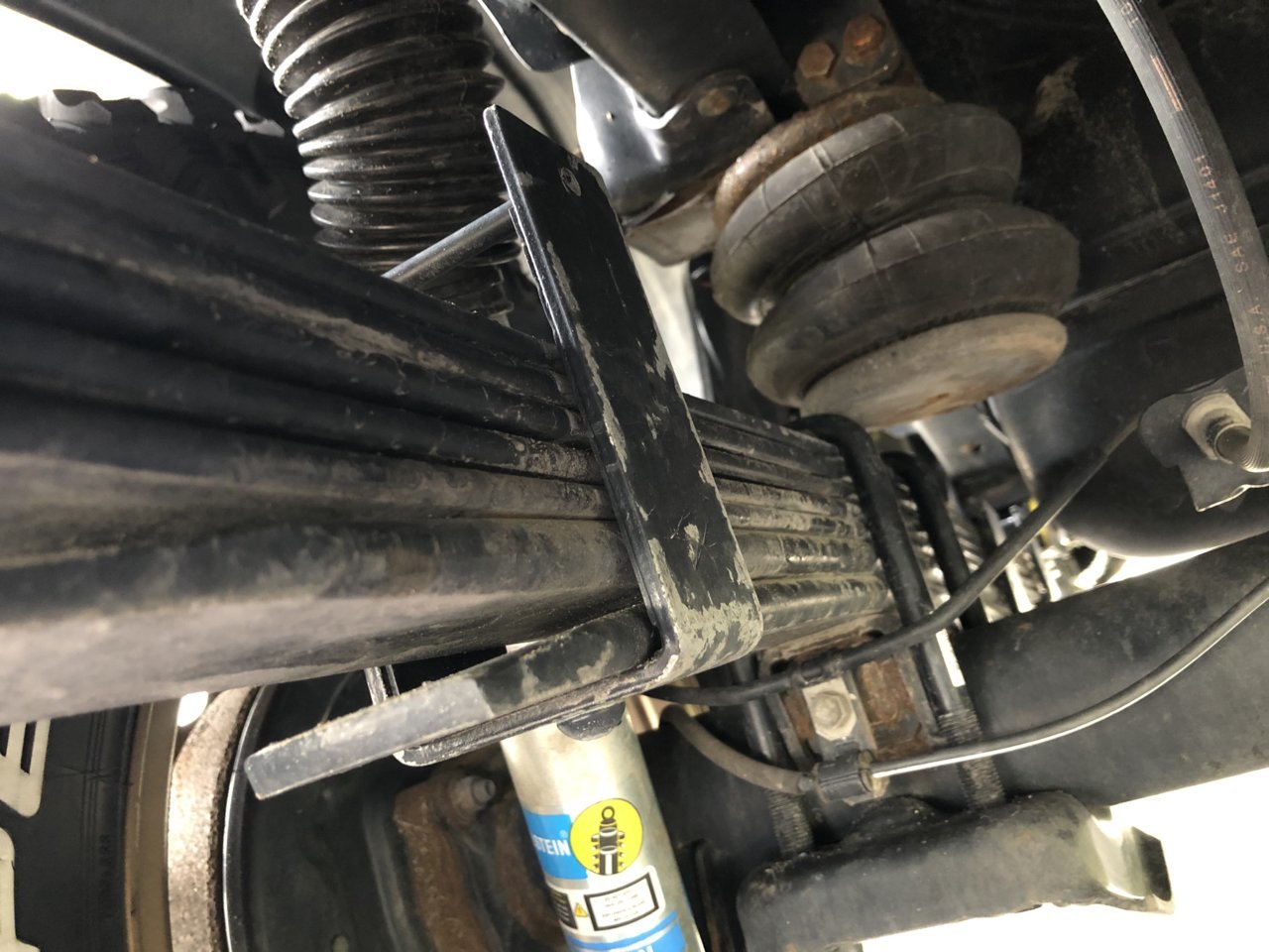

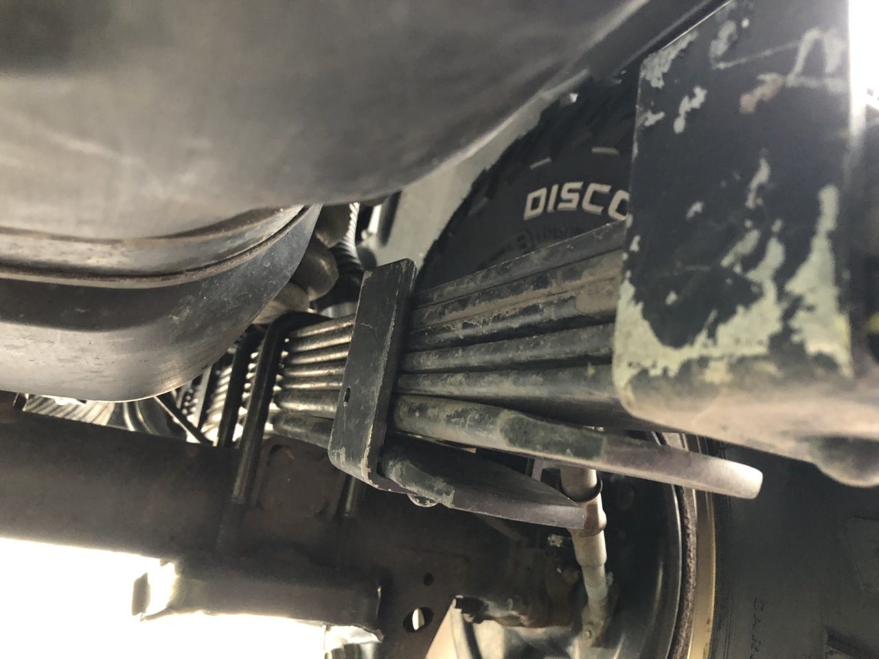

    Yeah, just start with the dakar AAL, that's what most people run and seams to be good enough for most guys.
    After you add the AAL if you still have problems cross that bridge when you get to it.
    Do you have a photo, because doesn't look like it's sagging very much.
    The dakars will give around a 3" lift but sag about an inch with a load.
    Do you have the 7 leaf pack. I think there is a 6 leaf pack available.
    So add the AAL will give you a 8 leaf pack and another inch of lift.

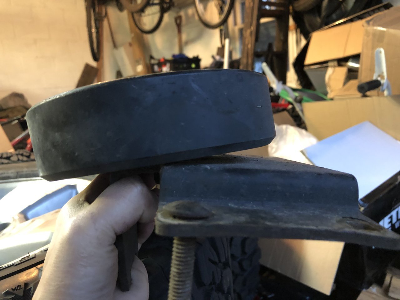

    If it's not sagging but you just want more lift maybe get the 3 leaf AAL and add 2 or 3 leafs to get some progressive lift.
