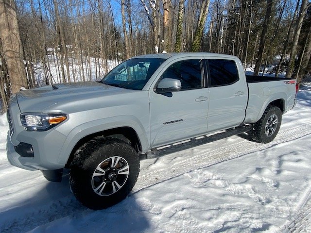

    This is my last call for help. I bought a 2019 Tacoma TRD Sport, 4 door, long bed 6 months ago. It has a 2 inch lift and oversize tires (285 70/R17). Since shortly after buying I noticed a shudder when driving easy at 40 to 50 mph, not while accelerating. It was probably there from day one.
    I have taken it back to the Toyota dealer 4 times. NO RESULTS. I have the extended warranty and they are ignoring me or playing dumb or maybe they are dumb. I have also taken it to a private garage that specializes in Japanese cars. They acknowledge the shudder but can't figure it out either. The truck is beautiful but it bothers me every time I drive it. The tires are new and have been balanced twice and I have had 2 wheel alignments in the past 6 months. Any ideas???
