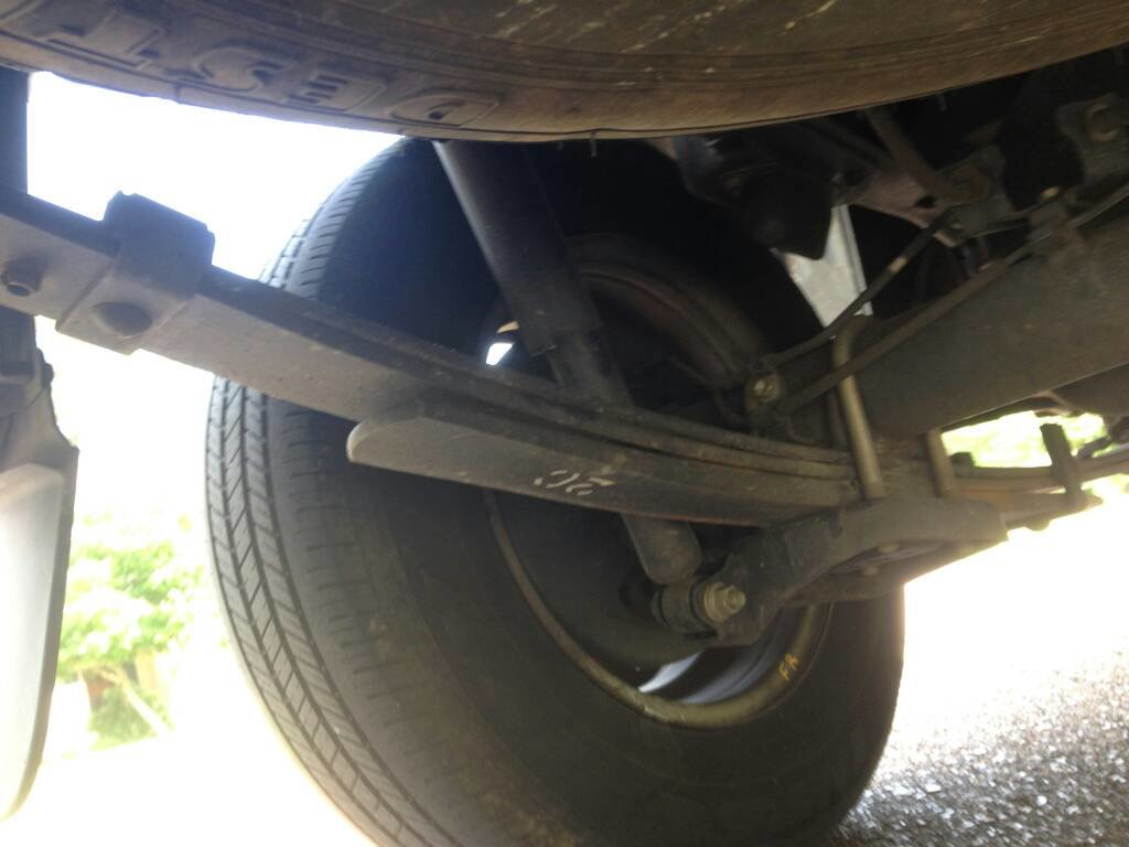

    count the leaf springs on each truck and let us know if they are different

    That's my dad's. Mine looks the same.
