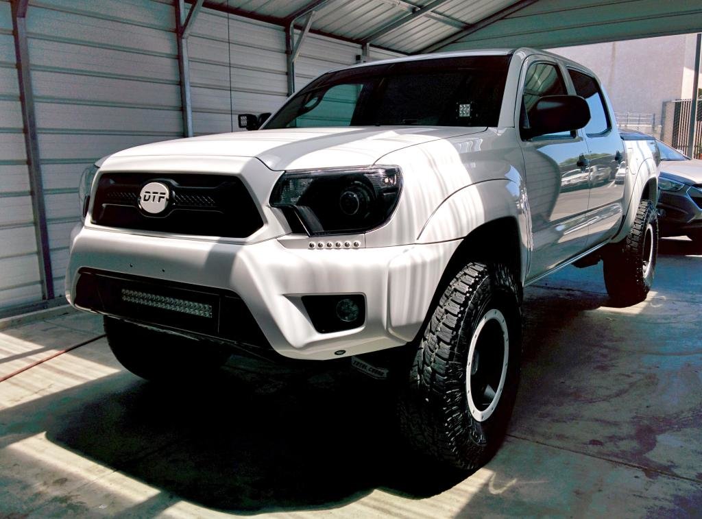

    Fresh in the detailing booth:

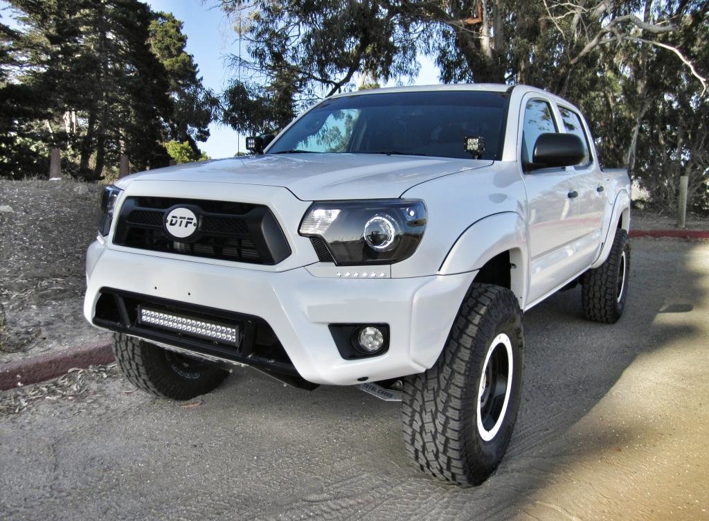

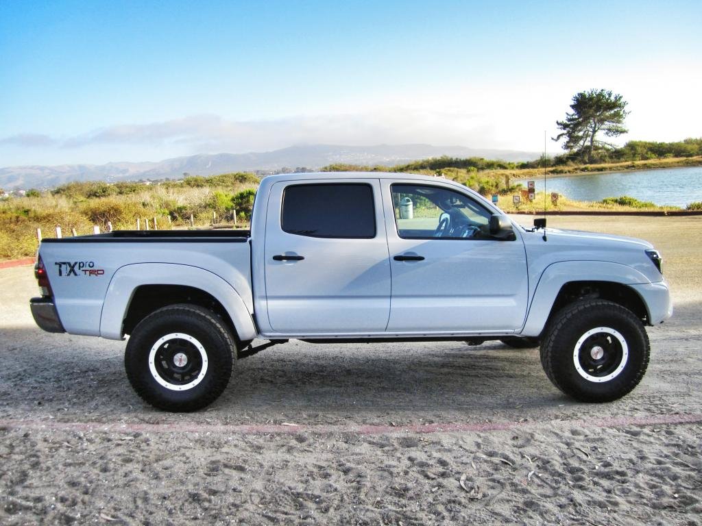

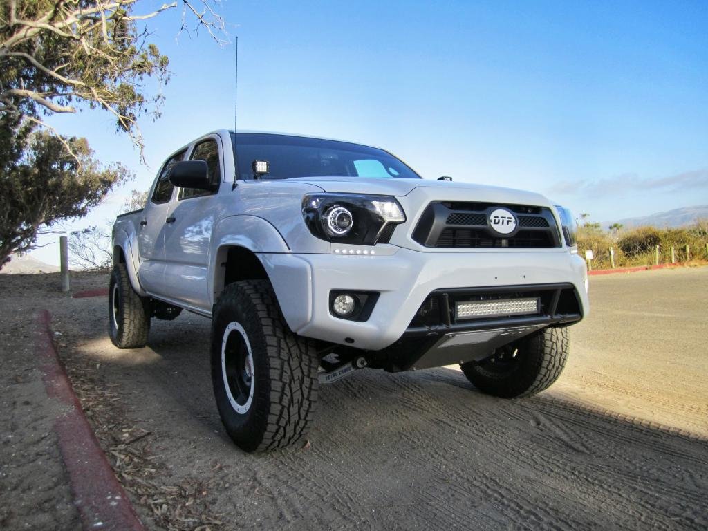

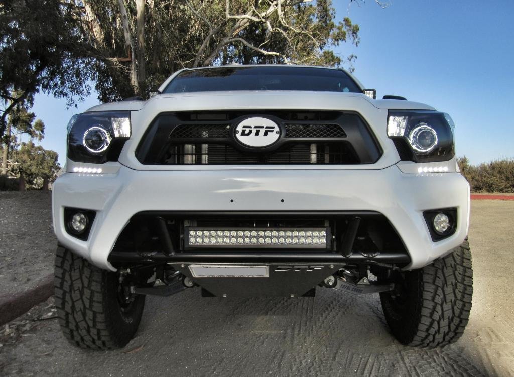

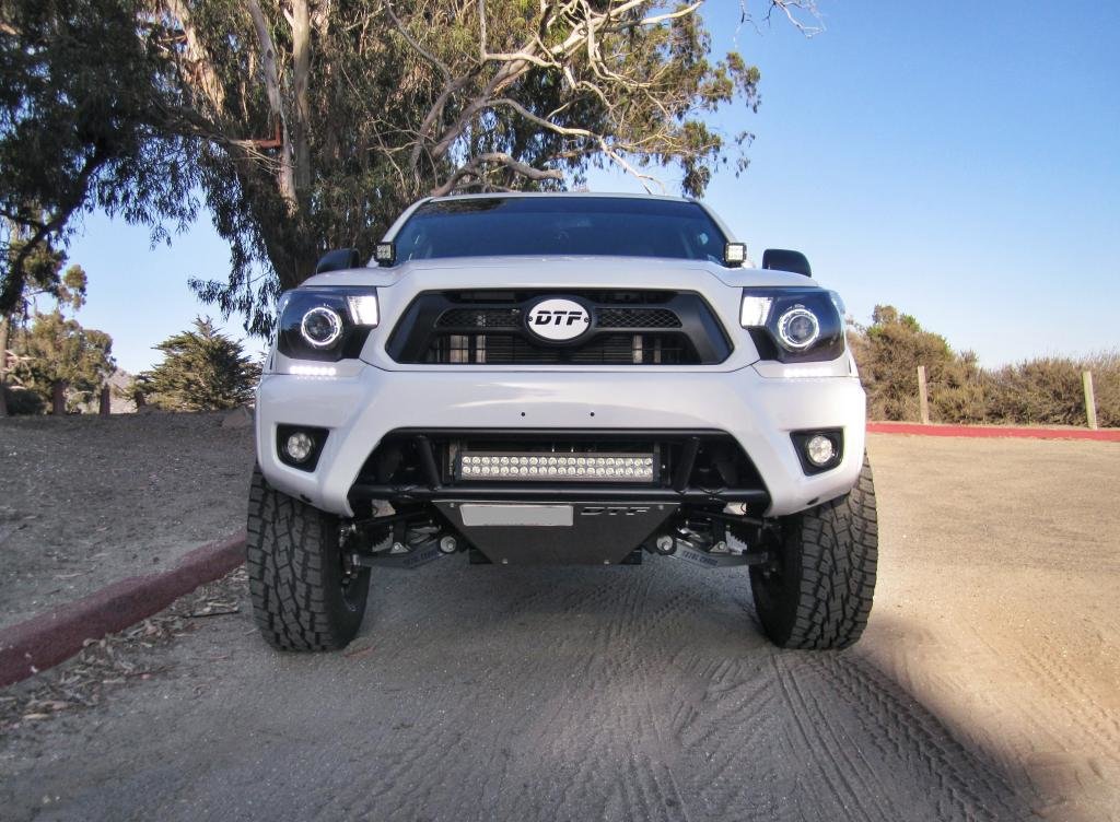

    Snapped a few new pics this evening:

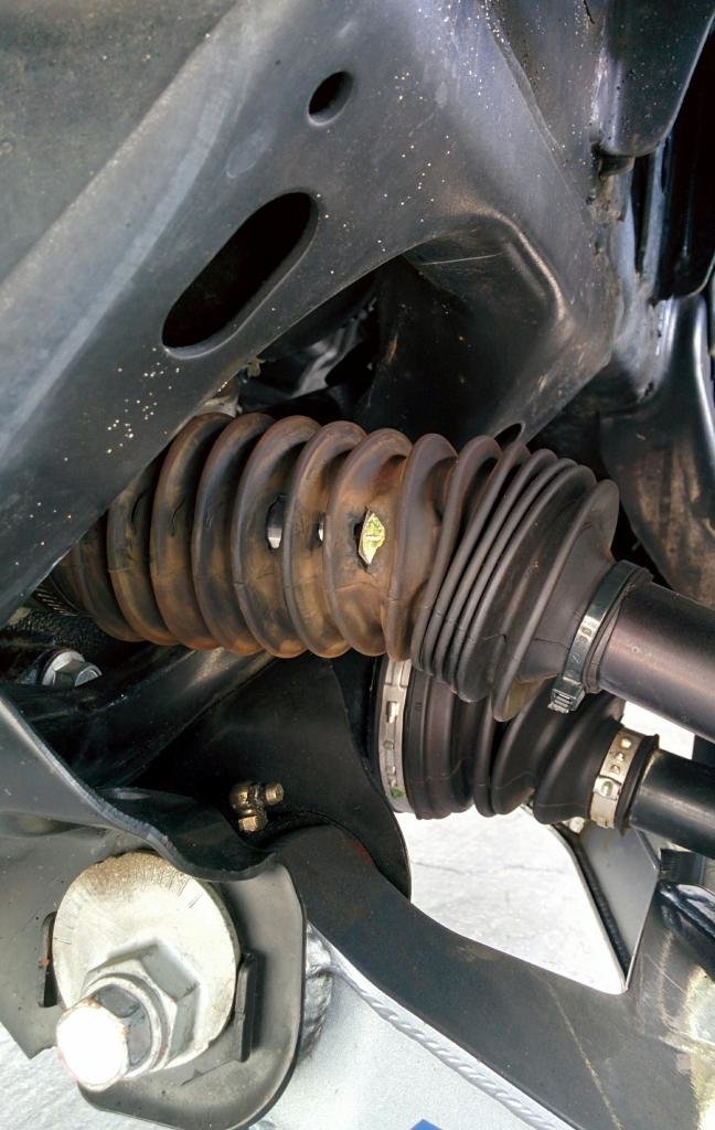

    DOH!!
    Usually shiny things are nice, but not when they're rubbing through a set of steering rack boots LOL. :eek:
    I guess romping out at the dunes finally made them rub through the boot. Oopsies.
    I had a feeling this would happen, as these Dorman replacement boots fit a bittttttt on the tight side when the homie Anthony (DTFtacoma) installed them. Driver side ripped, passenger side still ok---but I might as well have both replaced. Today I ordered a set of NAPA replacement boots that are pretty much double the diameter on both the engine sides and the wheel sides.
    specs of the old ripped Dorman boot:
    engine side: 1" diameter
    wheel side: 0.45" dimeter
    boot length: 7.5"
    specs of the new Napa boots ordered"
    engine side: 2.19" diameter
    wheel side 1.08" diameter
    boot length: 7.75"
    So the new ones will be twice as big, but maintain pretty much the same length. I can only assume the "accordion" portion will be much bigger on the new ones to fit the steering rack clevis bolts with more space.
  14. Jul 7, 2014 at 2:27 PM
    #814
    squint0241
    squint0241 OVRLND
    Jan 4, 2014
    #119916
    6,868
    Rick
    Tropics
    '14 DCSB/Off-Road 4X4
    Bone Stock
    Found a quick fix!...:D
  15. Jul 7, 2014 at 7:26 PM
    #815
    STiLL WILL
    STiLL WILL [OP] MY NAME ISN'T WILL
    Jan 29, 2012
    #71677
    1,434
    Matt [again, not WILL]
    CA
    2021 Tundra TRD Sport 4wd
    Yes, I sold my '13 Taco. :'(
    Lmao....I guess I should call and cancel that order at Napa then.
