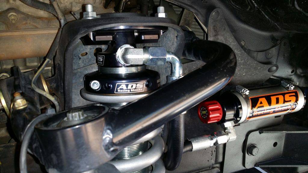

    Haha dude those sexy compression clickers tho!!!! Omg! Those look badass bro!!! I'll let you know how much each side is threaded up when I get home and over this bachelor weekend hangover for my brother. Lol
    Nice to see you officially join the ADS club, trust me it will only get bigger soon ;)
    Again, congrats!!!
    I must ask, how does the truck ride now sir????? :D

    Hell yea the clickers not only look good but man it's so nice having the ability to fine tune them with 20 different settings! The video on IG I had them set to 3 and it soaked up the little ruts in the road like a dream! We went to Rail-X which was alittle rougher terrain and I set em to 5. Having to go slower through most of the big washouts you could feel the coilovers cycling but in a nice and smooth way. I'm still testing out which settings do best in different terrain, but I was super excited to drive my truck even after riding in Jaime's LT front :cool:

    Damn thats badass I need to check those vids out on your IG! I knew you'd love your setup man. Really good to hear. Your truck Im sure will put even more people onto ADS.

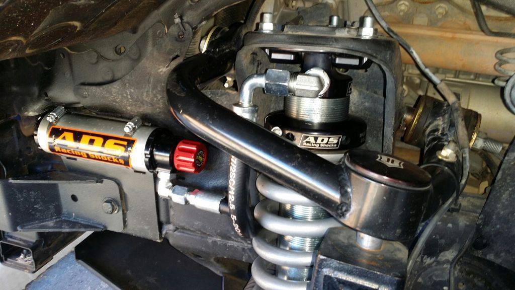

    Bro...nice setup! Suggestion for your Resi's. Go to the hardware store and get some of the black flat rubber baseboard molding and cut some thin strips the width of your clamps holding your resi's. Put it between the clamps and the resi body so the steel clamps won't corrode the aluminum housings on your resi's. Cheap and good easy mod to protect your investment...:D

    I personally never had any shock reservoirs show signs of corrosion due to direct contact with clamps on previous trucks.... and I live in a place that sees moist air every day from the ocean (I am less than a minute away from the Pacific). If anything the resi parts that are covered by the clamps end up being in better shape over time as the wear and tear sets in. The key is keeping the clamps nice and tight on the resis to prevent loose chafing due to vibration. Arizona is nowhere near the salt belt either so he should be fine regardless.
    Before winter I always spray Fluid Film on the suspension & underbody of my trucks and it's worked nicely.

    Right on Matt..:) I have my clamps on tight as well, but I noticed that when I was lubing my suspension and I removed the clamps from the resi's, there were signs of oxidation on the resi surface from where the steel was touching the aluminum. I also live close by the beach as well and have the same conditions as you. My buddy who is a metallurgist mentioned I should place the rubber in there to prevent corrosion over time. Glad to hear you're not having that issue bro>>>:D I've heard fluid film is a great corrosion preventer as well...might go that route since I have salty air...:D

    Thanks! I may look into this as my clamps actually moved abit after some wheeling over the weekend :/ I thought they were tight enough but either they weren't or its common for them to move around after some mobbing? :notsure:
    The custom stickers Brian made for me at ADS are larger than others so I stuck them over the clamps and noticed they moved

    ADS hard anodizes their resis, and they are stainless clamps. Not reactive like regular steel and bare aluminum.
    But 3m double thick shrink wrap is a great thing to put on the clamps. I do it on the disco truck builds cause they complain about bare hose clamps
