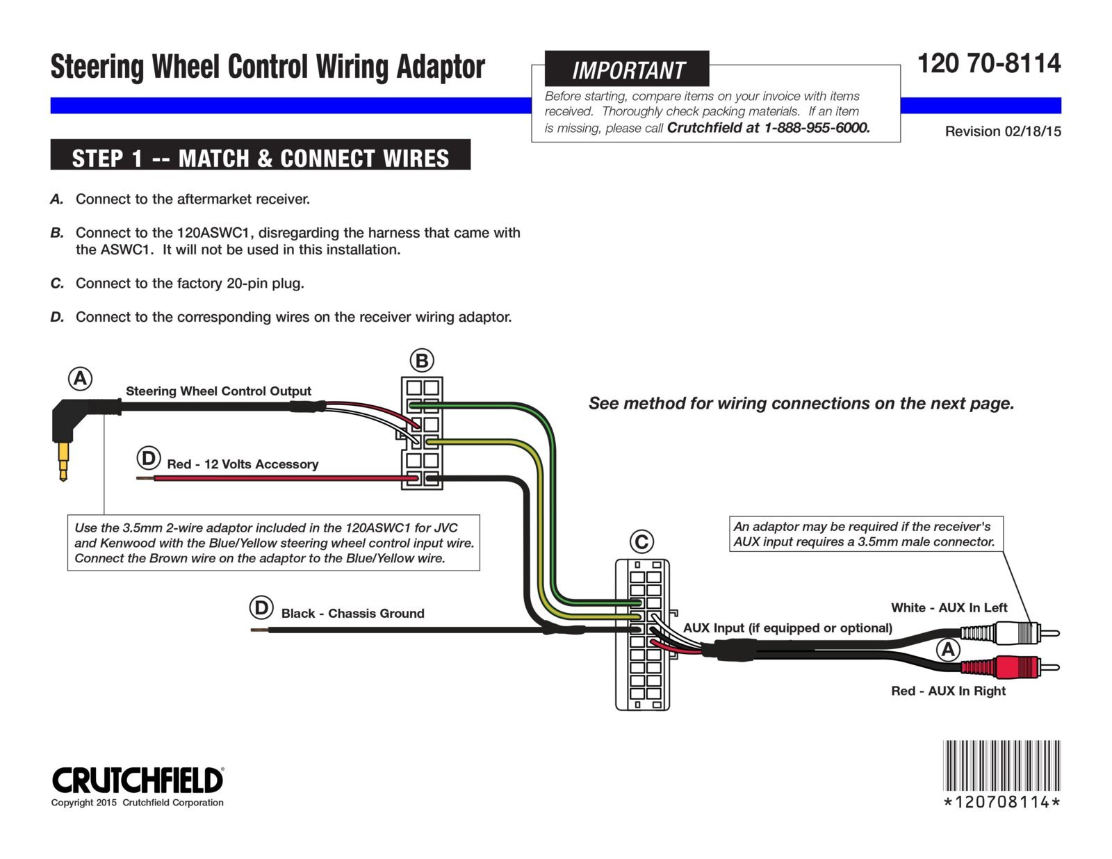

    I used the OEM radio mounting brackets (steel) rather than the plastic ones included with the Metra bezel.

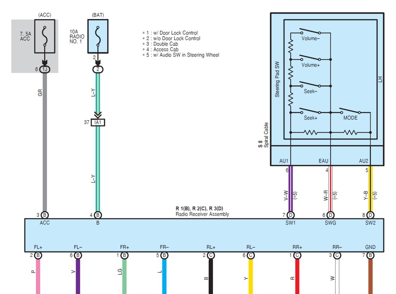

    Regarding the SWC, here is how I THINK that I did it 4 months ago;
    DISCLAIMER: Please don't blame me if you screw this up. I am recounting the info below from memory, and I find that my memory isn't what it once was.
    I looked at the OEM SWC wiring diagram:
    The SWC uses pins 6, 7, and 8 on the 20-pin connector.
    I then modified the Metra 70-8114 wiring by cutting the Green, Yellow and Black wire at CONNECTOR B (which will not be used), and splicing the G, W & B wires to the Grey, Green and Black wires of the PLZ C connector which was included with the radio (steering wheel controls - CLEARLY labeled). The white and red coax connectors on the Metra connector C are not used.
    Here is the PLZ wiring diagram:
    Then, simply plug connector C into the stock wiring harness, and the C connector into the radio, I programmed each button, and vollia!
    Ya, sorry for the hijack.

    Could the G,W,B wires (highlighted above) be a typo? Could it be green, yellow & black as mentioned in the previous sentence or am I looking at the wrong harness?
  19. Dec 8, 2024 at 8:25 AM
    #19
    eherlihy
    eherlihy 2009 Access Cab TRD Off Road
    Jul 17, 2018
    #259618
    191
    Florida or Massachusetts
    2009 TRD Offroad Access Cab in Silver Streak Mica
    Yes, it could be a typo. As I said, the post was made from my memory, which may not be what it once was (I don't remember).
    Rather than worrying about the color code, look at the pin outs on the connectors. Connector C (20 pin connector) Pins 6, 7 and 8 are used for SWC. The picture above shows the Metra Harness wire colors as Green, Yellow and Black. On the Head Unit the C connector harness colors are Grey, Green and Black. The Black is the only wire that is critical that you get right. I believe that the Green and Yellow wires are interchangeable.
