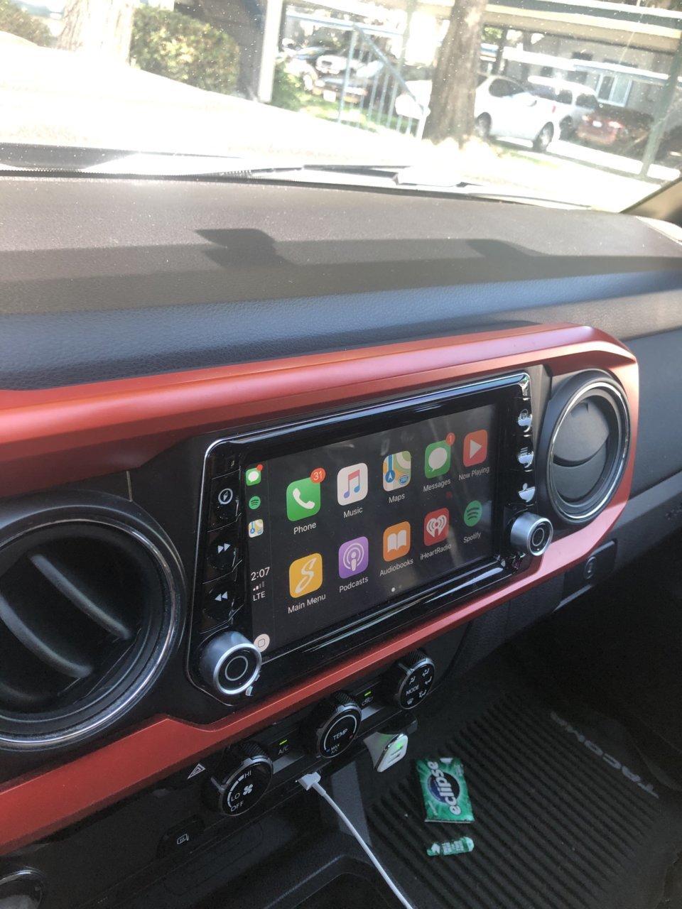

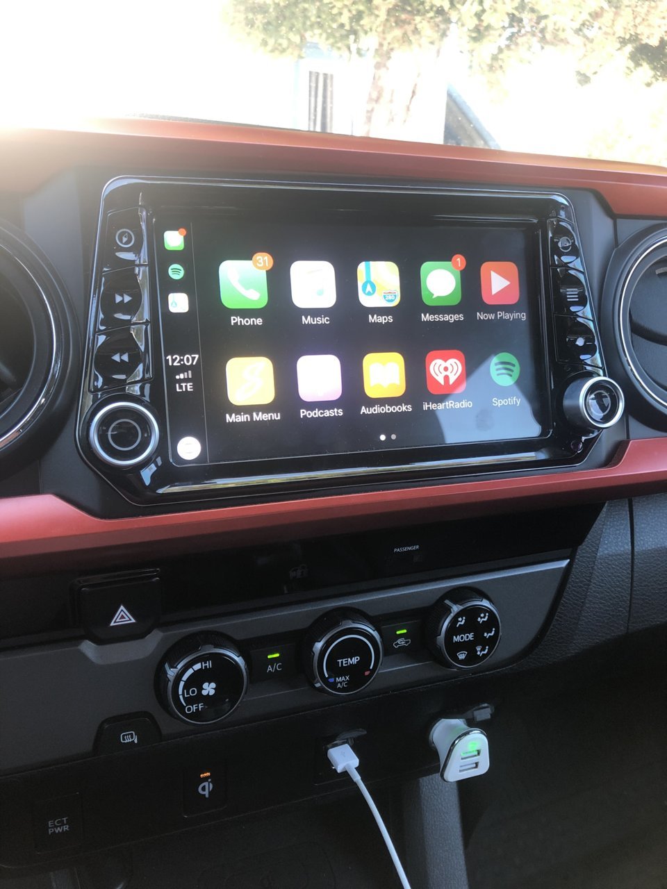

    I put one in my Tacoma I love it!

    Plug and play..or what else do i need?

    I did post on Facebook a while back! And it’s not plug and play you will need to buy a radio harness,backup camera harness, antenna adapter and factory USB adapter. The swc are built into the radio and I also chose to flush mount it using a router some body filler and paint. But that’s optional you can just buy a dashkit and have the screen float in front of your dash
