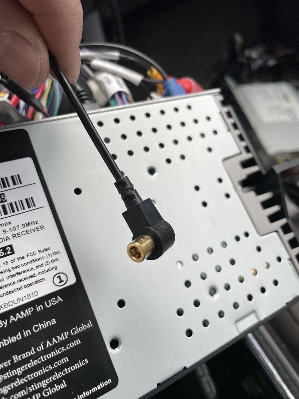

    I have a 2019 TRD OR with the non JBL stereo. Trying to install the Stinger unit.
    Where does this satellite connector attach to? I have Sirius XM on the OEM stereo.C93B18F6-8AE6-4342-B05D-EBD7D13E3C53.jpg
