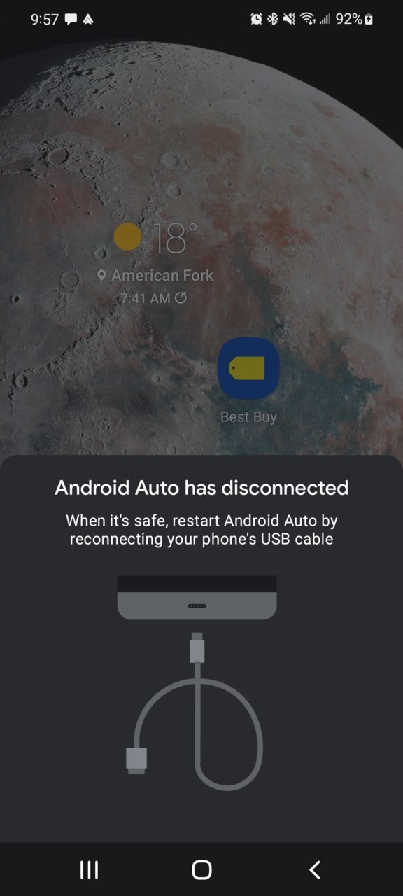

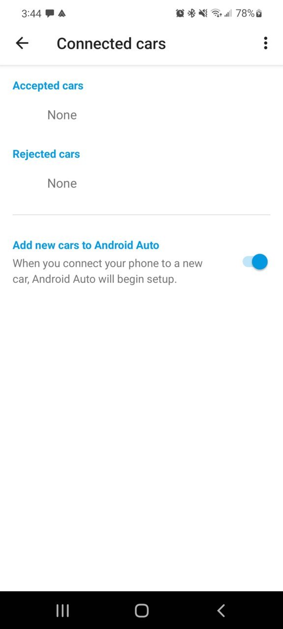

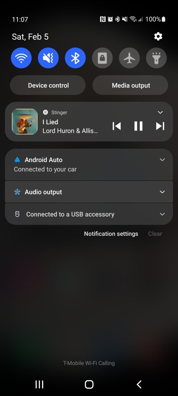

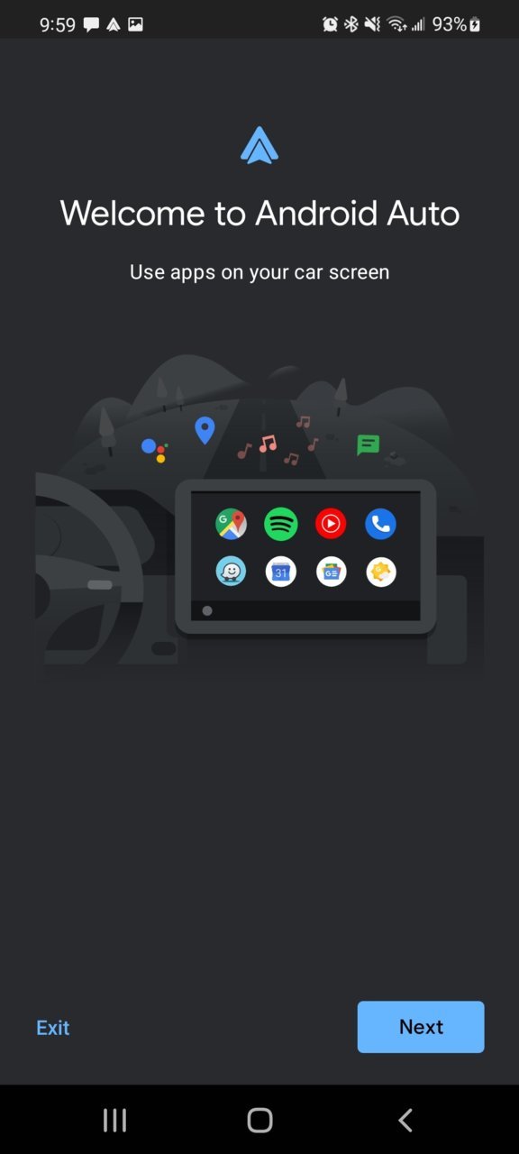

    Installed the Heigh10 and everything is working great and it looks awesome but Android auto is not pulling up on the screen. I've literally done every troubleshoot you can think of. I'm currently talking with one of their techs and he can't figure out what's going on either. Apple Carplay works just fine and I've gone through 4 different cables, including oem. Tried it on my other car with android auto with no issues.
    When I connect it it begins to respond to android auto then just goes to the main menu and android auto isn't highlighted. Then on my s21 it shows that I'm connected but if I go into the app it shows no vehicles. I was somehow able to get to the second step of setting it up this morning but then it crashed again. Hopefully there's a solution but I'm thinking I got a faulty "brain"
