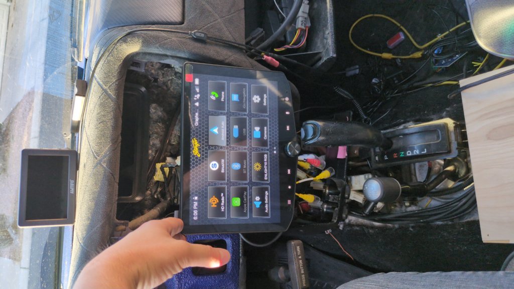

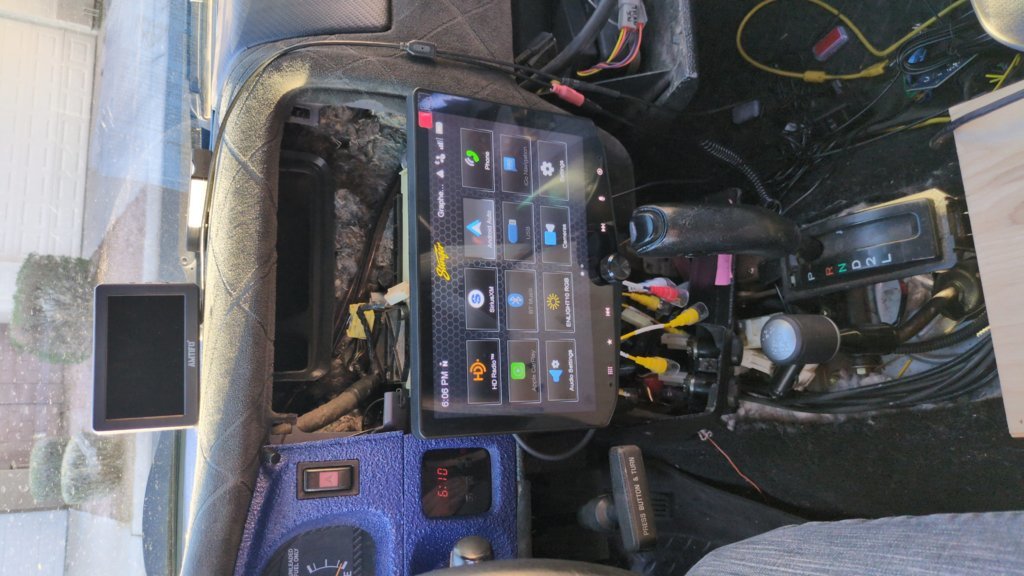

    Sad to say, I have to send it back. Either blocks gear shift or blocks HVAC. I do worry about the longevity of some of the nav buttons: if the menu button dies, you're pretty much stuck on the last thing you were on it seems. The 12" model does have a modular volume that you can replace knob fwiw. Their integration with only Audio Control DSPs seems egregious and why am I paying for that. Control of up to 4 relays is neat but I'd have to rewire a bunch of stuff to use the feature. I noticed a CAN line but no idea what it does. Backend seems to be a highly modified Android OS and DSP GUI is programmed in Unity for some reason. iGo over Garmin was dumb (can't use my topo maps) but the external GPS seemed to work immediately with no setup (android auto GPS permission was disabled and it still found my location instantly). RCA camera inputs is questionable given Amazon is saturated with the 4pin mini circular connectors for backup cams, and is what I have, so couldn't test it. Forbidden to type anything on screen if park wire isn't live.
    Going to try a 7" dual DIN wireless android auto unit from Amazon I got for $120 tomorrow - seems the only things I'll lose are HD radio and optical out for my use
