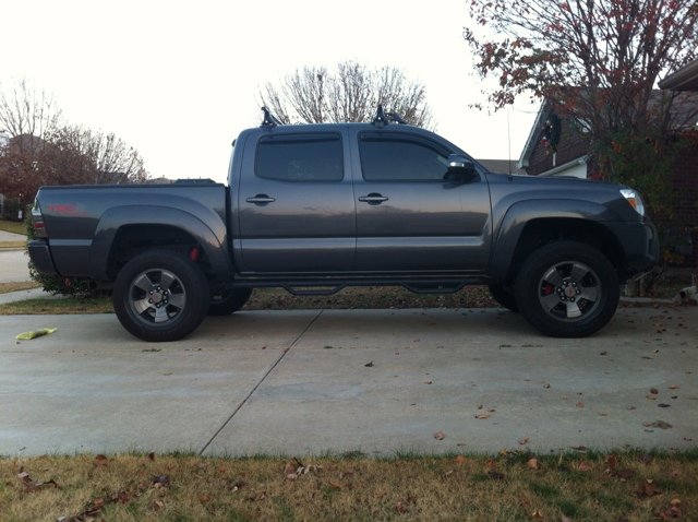

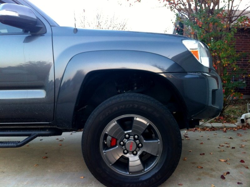

    Finally painted the wheels.
    As far as prep and painting, here are the steps I took.
    - removed weights from front lip
    - washed with soapy water and scrubbed with green brilo pad
    - dried with towel
    - wiped with tack cloth
    - sanded with 600 grit
    - rinsed thoroughly with water
    - Dried with towel
    - wiped with tack cloth again
    - taped off valve stems by wrapping tape around stem
    - used index card method between wheel and tire
    - primed with self etching primer
    - dried/heat cured with a heat gun
    - lightly sanded any necessary areas that were not to my liking
    - wiped sanded areas with tack cloth
    - painted with duplicolor "graphite" wheel paint
    - heat cured again
    - let them dry overnight (10-12 hours) in the garage
    - next day I took and had them balanced with sticky weights
    - admired hard work
    I tend to over prep, but I have found it better to over prep than to under prep. I have found myself overusing the tack cloth, but I would rather overuse it than have dust and hair particles on the wheel and paint over them.
    Just an FYI for those wondering, yes I painted my calipers red, and my rear OME shocks red. I hated the yellow color the OME shocks were. So, I sanded them down, primed them with universal primer and sprayed them with red VHT spray on caliper paint. Actually, I painted one rear with primer and paint, and the other with red Plastidip, as a test to see which I liked better and which holds up. I will be removing the plastidip from the one rear and painting it with primer and VHT caliper paint. As it looks sharper. The calipers I actually painted with the brush on style caliper paint since its easier to work with on the calipers.
