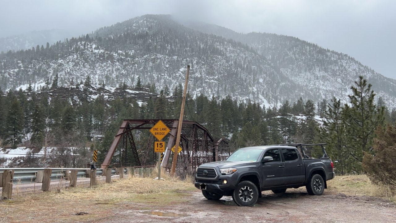

    Hey everyone,
    I have done 100+ hours of research on this topic and wanted to get some final advice from TW before pulling the trigger on my first tire upgrade for my beloved 2018 Tacoma TRD Off Road MT. There are countless threads on TW discussing this topic, and it feels like I have seen most of them several times now.
    • Will 265/75/16 Goodyear Duratracs on stock TRD OR wheels rub on a stock 2018 TRD OR with 1.25" spacers?
    I am fairly certain it will not rub without spacers. I know there are valid reasons against getting spacers. I finally found a shop willing to install them and, after so many months of deciding, it feels like I should go big or go home on this one. These trucks looks better with a wider stance imo, and I want to get as wide as possible without a lift.
    I have read some reports of no rubbing with this setup, slight rubbing when turning hard onto a dipping road, all the way up to a "ton of rub". I can get the tires and spacers by this weekend, but am not sure if I should also order a set of .75" or 1" spacers, or how hard it is to get them off once they're stuck on there. After looking again just now at the gaps in the wheel wheels, it doesn't seem like pushing them out would cause more problems than the larger wheel size itself.
    I sincerely appreciate this forum for guiding me this far in this decision, and also Discount Tire for providing me (on TW) the quote that finally made me willing to pull the trigger. Here are some recent pics of my truck in Montana and at Lake Coeur d'Alene. I love it so much and I just want the best for it.

    I have those tires on my stock OR wheels (no spacers) and there is absolutely no issue, it's only a 1 inch difference (3.4%) between stock and those Duratracs.

    Great pics!

    Thanks man! First long road trip with the truck. It was such a great time.

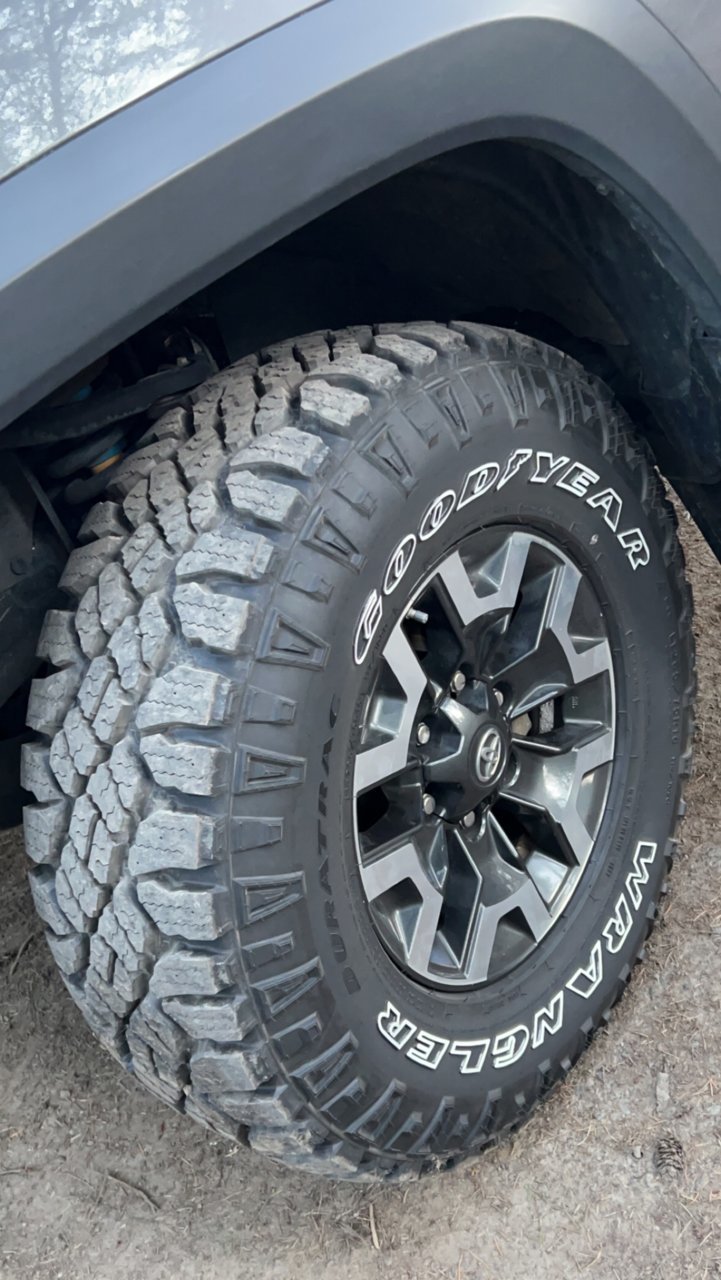

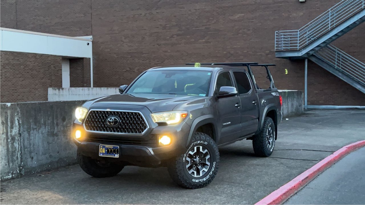

    Update if anyone's interested:
    I got the 265/75/16 Duratracs installed today at Discount Tire. They agreed to install hubcentric spacers, but I decided to have the new tires mounted first to see how things look without them.
    I feel like the 1.25" spacers will fit. Maybe even 1.5", but I've never heard of anyone running this setup.
    The truck feels fantastic. The manual transmission likes the additional weight, shift points are a little different but actually better and more balanced on the low end. I haven't taken it to highway speeds yet.
    It looks great as is imo. I'm still interested in the spacers for cosmetic reasons, but if anything I think performance might be degraded slightly. Tempted to hit a trail tomorrow to test these things out.
    Total cost out the door including installation, balancing, disposal of old tires and rebates came in under $800. I'd expected to pay north of $1200 -- shout out to Discount Tire.

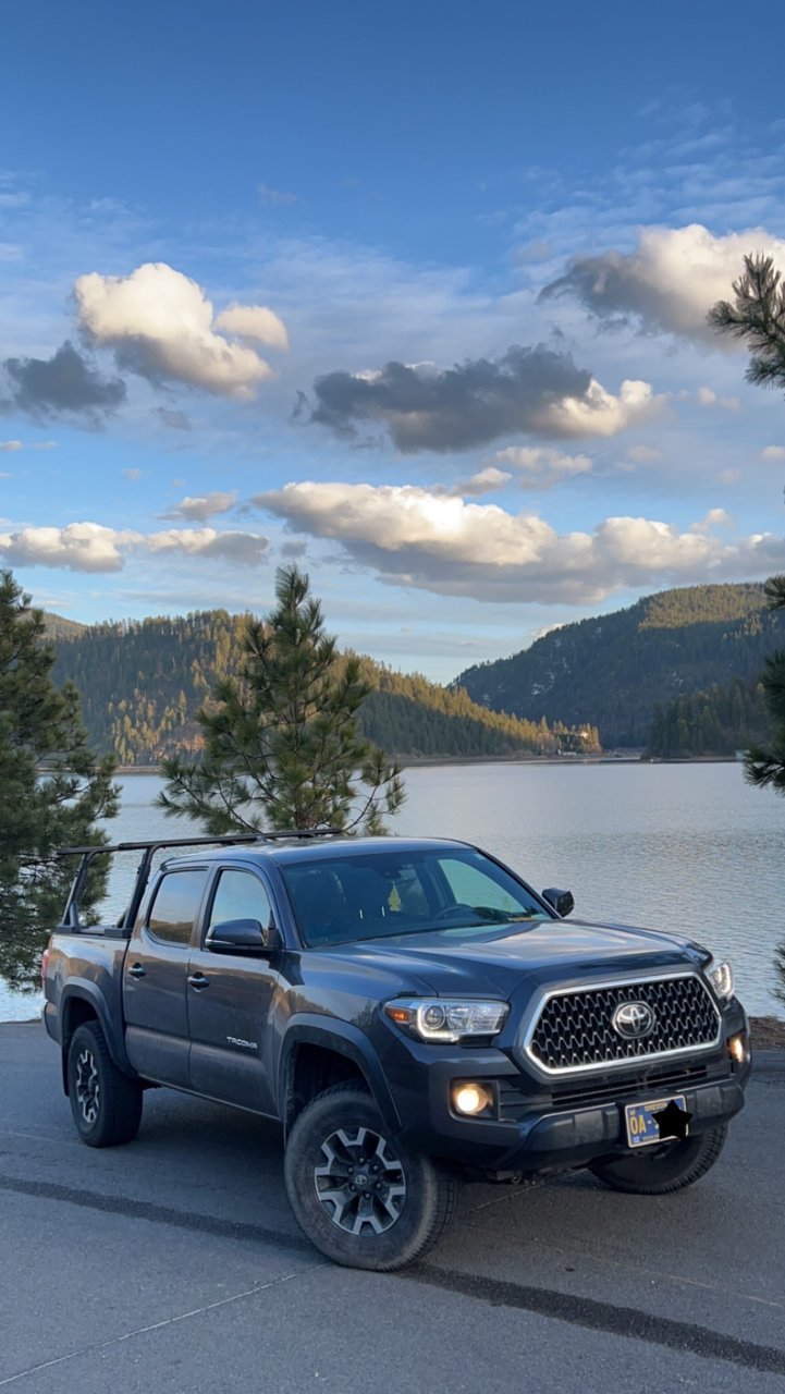

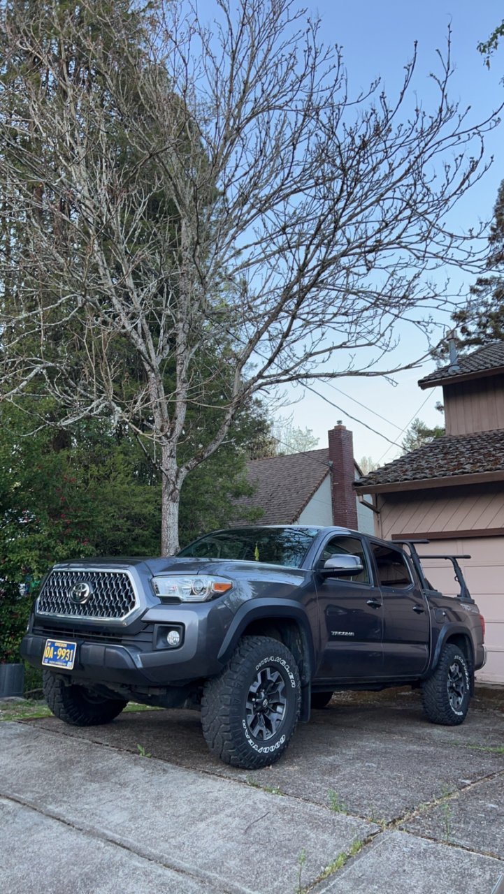

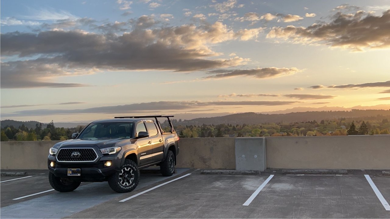

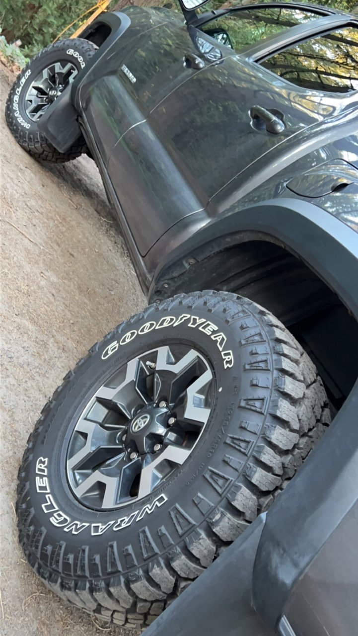

    Couple more pics of 265/75/r16 Goodyear Duratrac on stock TRD OR wheels for anyone who is interested. Ride quality has greatly improved. You really feel that there is an extra inch of rubber. I've thrown it around some corners like I used to, and once the back end kind of throws itself out and comes back to equilibrium, there's a little bit of bounce-back that you can feel down low. It's hard to explain but it's kinda nice lol. The first few gears work better with the added weight and wheel diameter. Just in my time driving it around town, the speeds at which you can cruise in 1st or 2nd are much more practical for going through parking lots, etc. I feel that it will improve off-road capabilities in this same way. I haven't put into into 4Hi or 4Lo yet.
    I took it to 75MPH today for the first time, and it felt amazing. A nicer ride than the 265/70/16 winter tires for sure. The added height is subtle, but you can tell the truck feels bigger when you're driving it. Absolutely in love with this thing right now.
    I know the Duratracs supposedly get louder as the miles on em increase, but there is absolutely no issue with road noise and tbh I'm kind of annoyed at all of the folks acting as if that was a major issue with these tires. It makes me wonder what a true mud tire actually sounds like if these are so aggressive looking, yet quiet.
