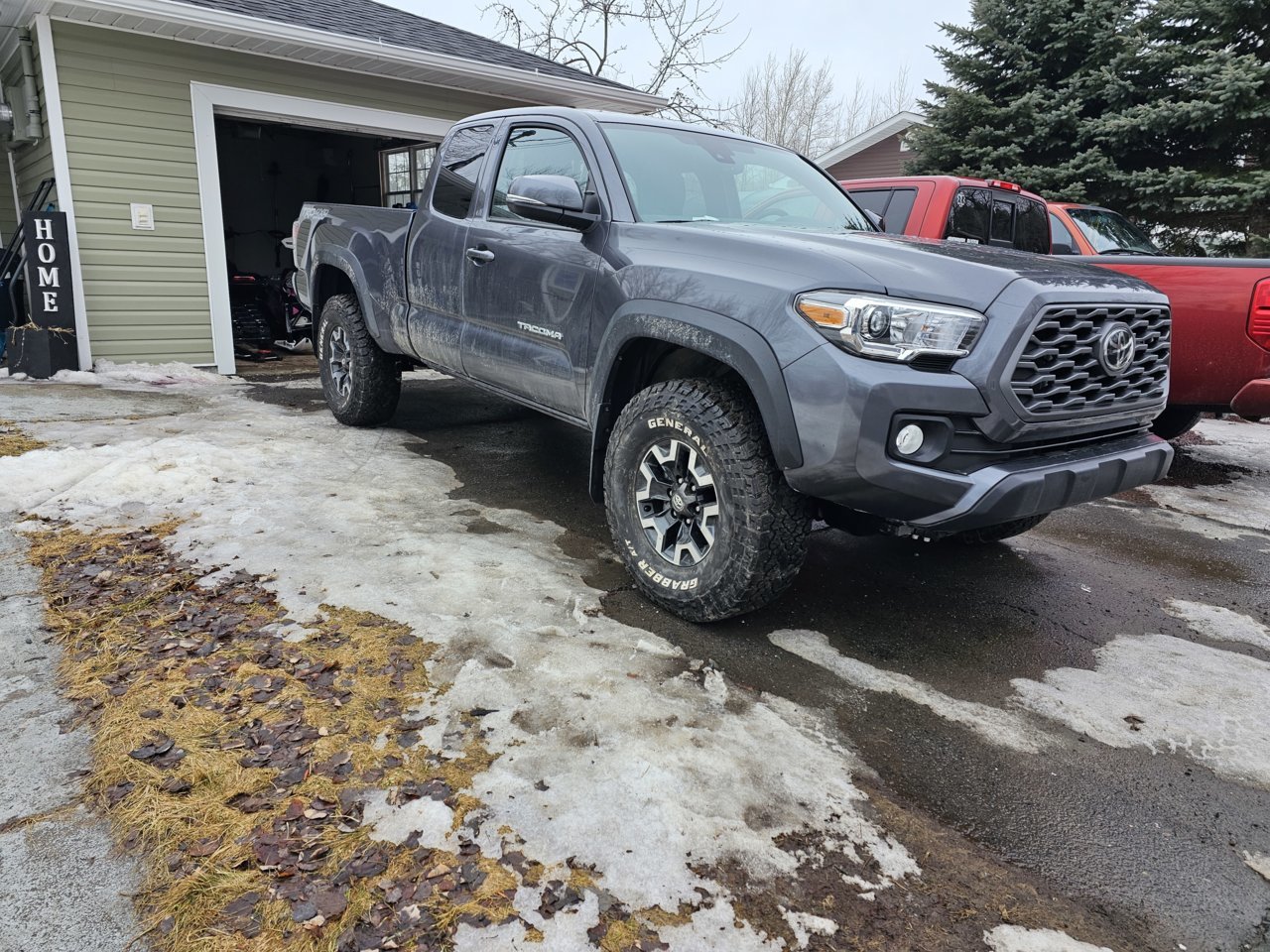

    icon stage 10 kit, toytec 1" bl, 35" general x3s, 17x9.5 procomp wheels, locker anytime mod, s&b intake, blackhawk 2.1 tune,
    he put what ive been trying to tell people for years (and continually get called a liar for lol) into a visual representation.
    with the right wheel specs 285s fit with zero lift and zero modification. heres my personal truck. same setup with 2" wheel spacers required a large cab mount chop

    @devinzz1
    What wheel size and offset? Rub any on full lock and pavement only?
