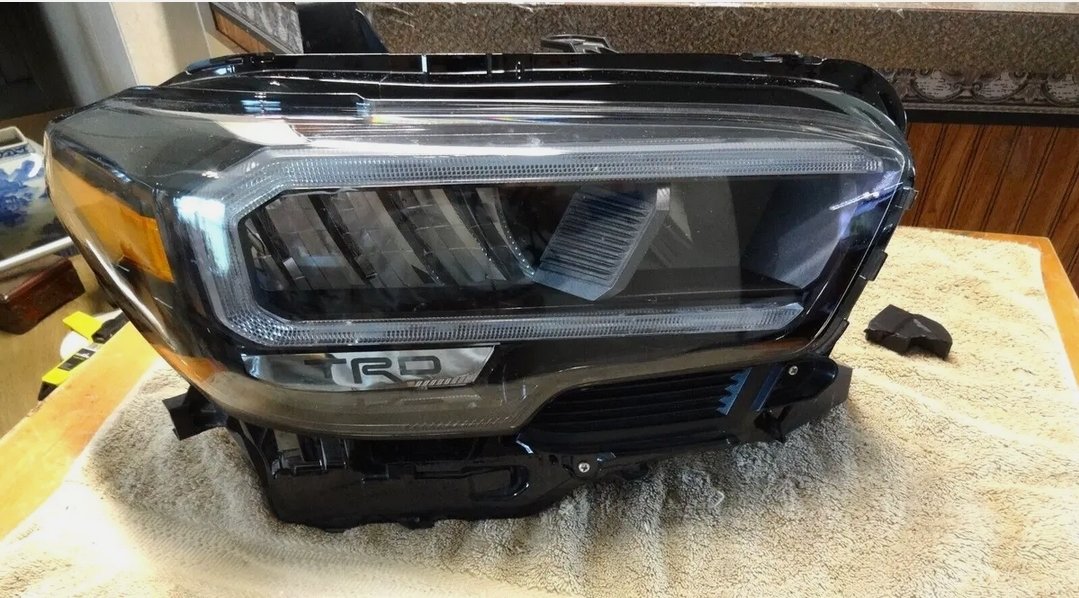

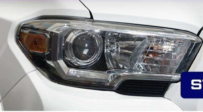

    Just to cover all the bases... OP, do your headlights look like the first or second pic? Screenshot_20230701_210851_Firefox.jpg Screenshot_20230701_210811_Firefox.jpg
    If your factory headlamp is the LED lamp, with the full width reflectors, then don't worry, they'll likely outlast the truck (with, likely, an eventual lense polish and re-clearcoating). If your factory lamps are the low beam projector style, and they're making a non-halogen color temperature, then you may want to check your build sheet. Toyota does not make a drop in retrofit LED based lamp. If your headlamps are the OEM halogen, but were sold to you as "LED," then you need to have a sit down with your dealer.
