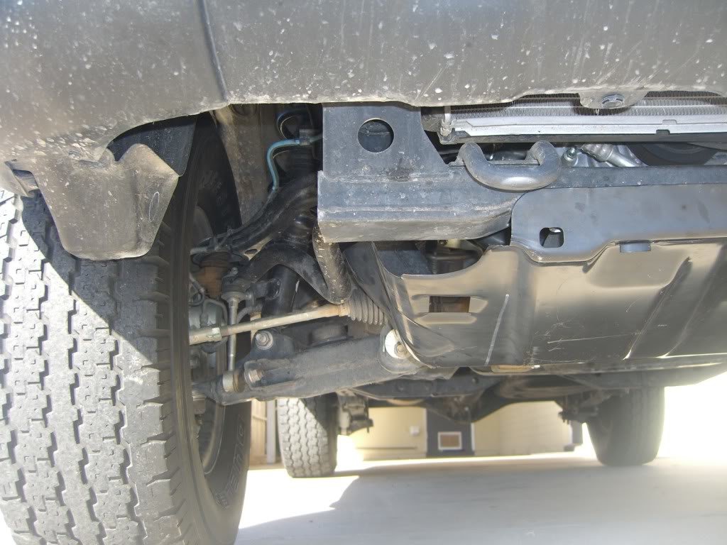

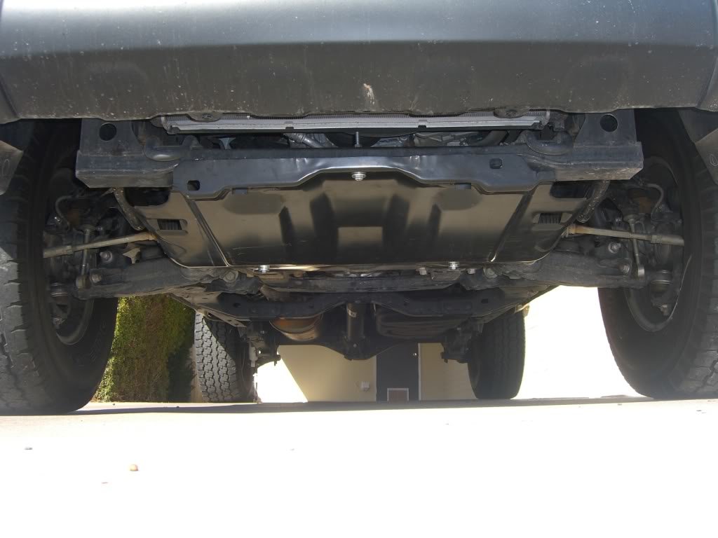

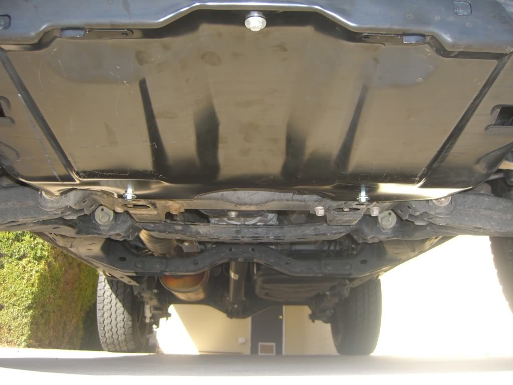

    Then I went to my buddies house where we talked about how to mount it. No holes lined up. So this had to be completely custom. I figured out where I want the mounting points to be. Two in the back and one up front. The reason for one up front, is because nowhere else on the front the skid touched in large enough area to drill & get a sturdy bolt there. I got Drill bit for hard metal from ACE hardware and some 8.8grade hex bolts, washers & nuts.
    Install was easy. I had my friend hold the skid tightly to the truck, while I drilled. It turned out great and it should provide some protection. I am not certain about just one bolt up front, however I think it will be ok.
    Now for pictures;
    The skid even clears the front sway bar, gotta make sure that the skid is centered and that same amount of clearance is on both sides of the front sway bar.
    In this picture you can clearly see the one bolt up front and two bolts in the back.

    Looks good, you just need to extend it so it covers the oil pan.

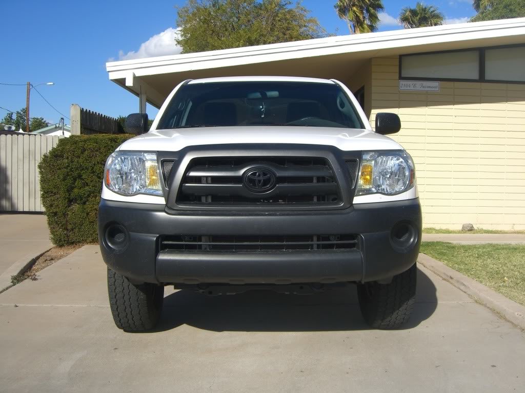

    OP, with the truck parked, are you able to tell that there is a skid plate under it?
  16. Apr 22, 2011 at 8:26 AM
    #16
    05RedTaco
    05RedTaco [OP] Nom Nom Nom
    Sep 20, 2010
    #43521
    1,751
    Tony
    Scottsdale
    2000 Tacoma XtraCab 2.7L 4x4
    Yes! It looks installed the same as on any 6lug Taco...
