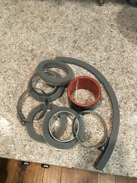

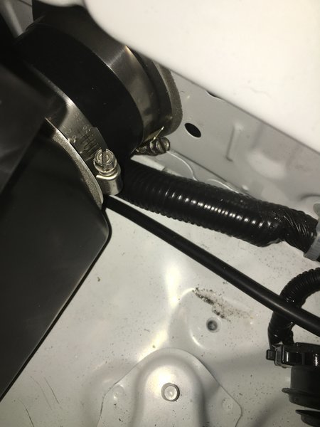

    OK so I've been driving this truck around today, and there is a definite increase in midrange response. I drove it thinking subjectively this morning, and I was pleasantly surprised at how much smoother it drives. She doesn't fall on her face in the 2500-3500 rpm range anymore. You can hear air flowing a lot better in that rpm range as well. I'm going to test the MPG changes over the next few tanks and report back, but the is a definite improvement in driveability!
