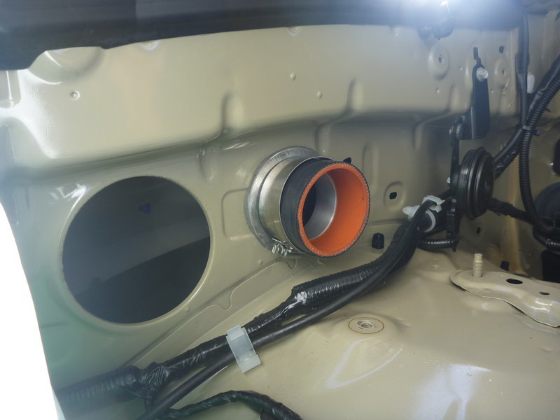

    Question: Once everything is installed, do you now have an open hole in the wheel well?
    Anyone have photos on the other side of the sheet metal? Do you guys add ducting or is it just open?

    There is another tube in the intake that opens to the inner fender area. This opens up a second hole right beside it. The wheel well guard still protects that area.

    This kit comes with everything to add a second intake tube into the wheel well right next to the existing one. No open hole.

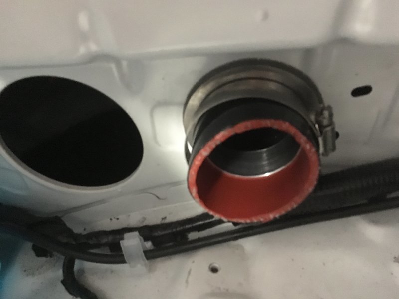

    Take the airbox out, and you will see the hole on the left. There is a tube attached to the airbox that reaches through there. The tube on the right is the one that gets installed in the engine bay. (Don't mind the crooked cut. This was the original prototype that I had to trim down.)

    The stock air intake taps into the fender well for two reasons.
    1) This is an area where the coolest air can be taken in.
    2) It's enclosed so no debris can enter the intake.
    This is why it was the best idea to add a second intake tube in the exact same area.

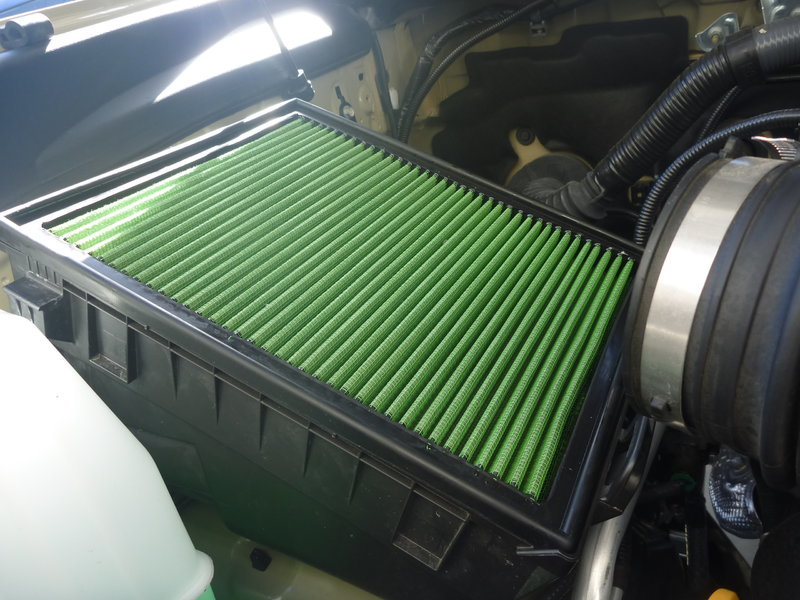

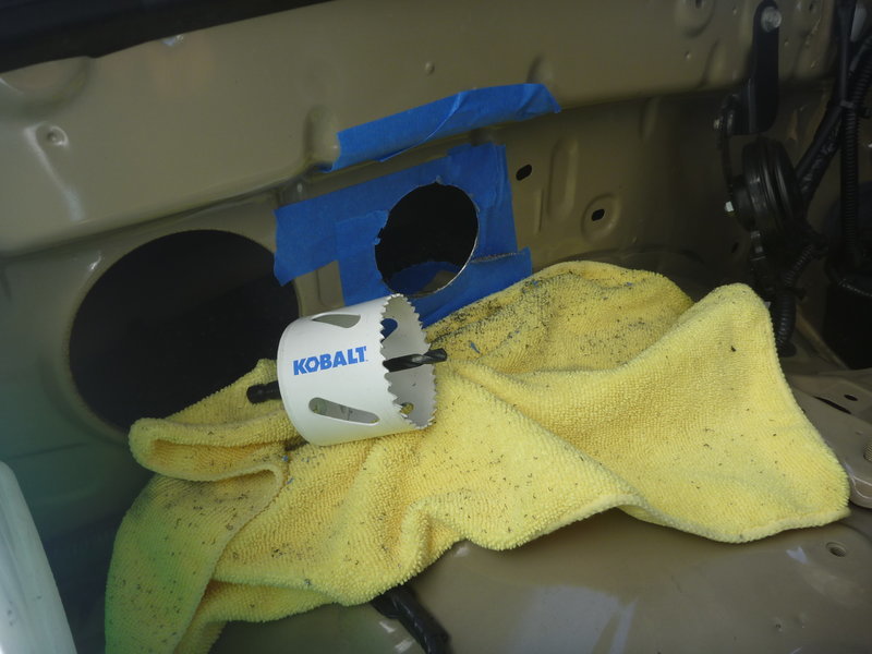

    Just installed!
    Sheet metal no match for a new Kobalt 2 1/2" hole saw
    With Green Air Filter
    Done!
