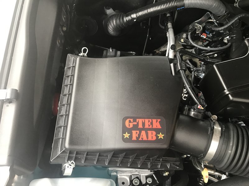

    Finally got my installed!!

    Sweet stickie placement too!

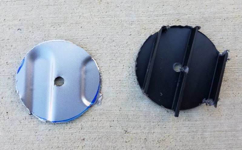

    Yes I installed mine last weekend. I have picks and will get them on here eventually. As the above poster mentioned, snapping the fins off is the way to go. I went a step further and scored them with a knife first so they broke just about clean off, sanded off the remainder and it was smooth as anything. Instead of a hole saw I used a hole punch, which ended up complicating things a bit as a 2 1/2" punch is more like a 3" saw bit. Had to use a 2" and reem the hole out a little to get the flange to slide in. Performance wise haven't noticed anything major but she does seem to be breathing easier, noise is maybe slightly louder. I'm glad I went forward with the product. I'll keep you updated on performance and gas mileage as time goes on.

    no drift or tape, just messed up a tad....lol!
