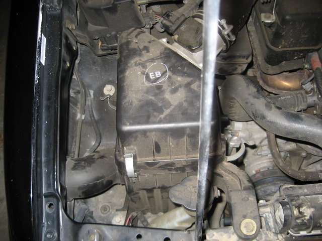

    How about this... Ill put up a pic of my 2.4. Someone else put up a pic of their 2.7 airbox (please :wink:) Then we'll compare.

    Here it is... pre deck plate even

    Should be the same on the 1st generation. I use the have the 2.4 2000 model, replaced the intake system with k&n air intake, and then sold the truck. Then I bought a 2.7 2004 2wd truck to upgrade the intake system, realized I should have kept the k&n from previous truck. It is completely identical.
