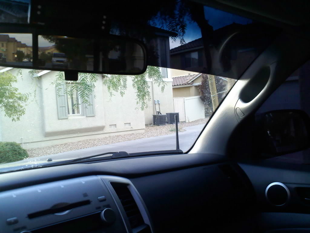

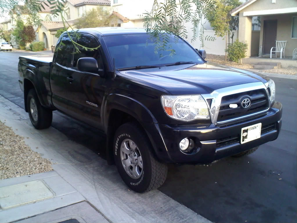

    I've got a custom S2K antenna...reception is better then stock antenna plus it doesn't blow 1/2' back when driving at high speeds...

    hey could you get me a closer picture of the atenna and how it scews on? How much does it show inbetween the anteanna and silver ornament?

    what I did is take the stock antenna take the plug out that screw into the receiver. from there I take apart the S2K. I then use the plug I pulled out of the stock antenna and insert that into the S2K also using epoxy to hold the plug in place. once that has dried I use a small rubber bushing you can get from lowes or home depot...that way the antenna sits flush to the receiver (where you screw the antenna in)...

    I want to see too! It looks way better than stock
