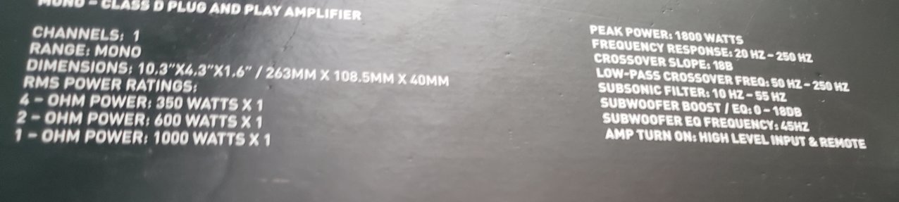

    And you're running the sub at 1 ohm?

    Still seems like a ground or the amp. This is a ********* setup yes?

    Yes. Checked many times and ground and power wire all properly secure. Might try with just the 100 A fuse, take the 2nd fuse (25A) out the line.

    I wonder if this amp isn't really 1 ohm stable. The amp will be making more power when you start the vehicle & that might be enough to trigger protect with such a low impedance. Amps (even class D) also get pretty inefficient at low impedances. So it should definitely blow a 25A fuse trying to give the driver a kilowatt. Even at 100% efficiency you'd be drawing 31.6A.

    #229363
    1,468
    Colorado
    2017 SR5
    That's my guess. His single sub must be a DVC 2ohm setup, so wire it for a 4ohm load and see if the amp still shuts down.
