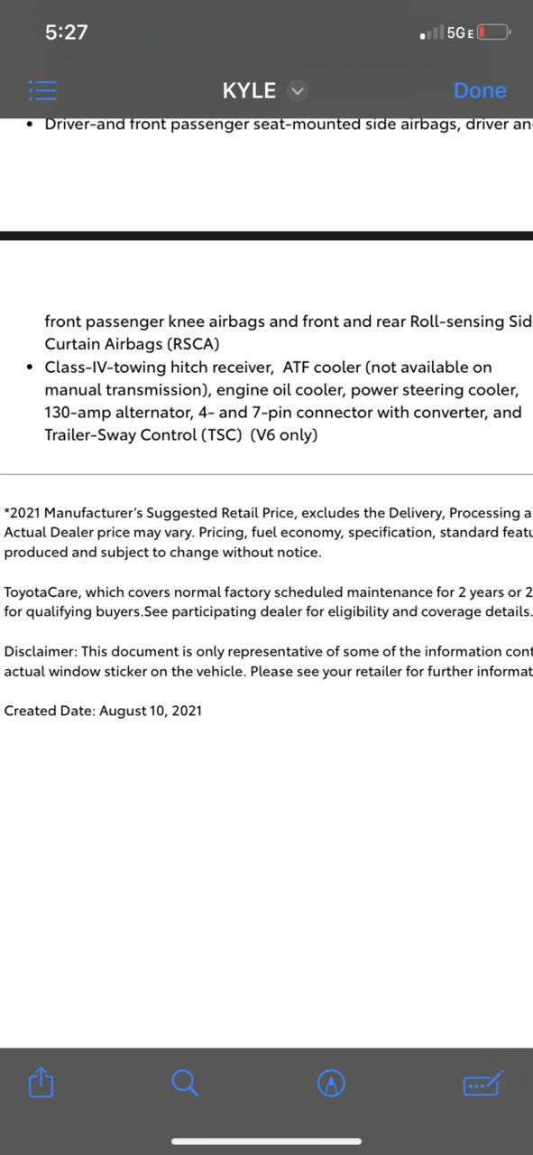

    Yes it’s a v6. I may be wrong, but don’t all the new tacomas come with a tow package?
    the sticker from my truck had this so I’m assuming I have the package…

    I believe the V6 do... I was just hedging my bets... maybe you had a 2016. Also, I am lazy and didn't read that you have a 2021 Off-Road. That would have told me you had the V6 with a tow package.
