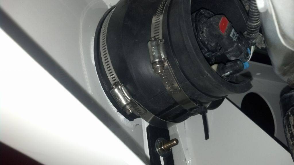

    Kings, JBA, BAMF, C4, Deaver, Prinsu, TJM, SnugTop, 5.29s
    I went this route as well, just tweaked it a little bit. My fernco came with a 4" & 3" clamp, and I used both. Put the fog in the rubber, and it will be tight!! But it will go on, just have to work it a little. I notched the front of the fernco so it would clear the mounting tab. I put the larger clamp over the front of the rubber and L bracket supplied from Eric. And thought good enough. Except they point right at the ground. So, take the other smaller clamp, and put it around the back smaller part of the fernco and the back of the L bracket. The L bracket isn't quite long enough for the clamp to stay on very good, so as a temporary fix, I've used a zip tie to keep it from slipping off. Now to adjust, just tighten the rear, smaller hose clamp to bring the beam up.
    Drive and enjoy!!
    Heres a pic in case my rambling doesn't make sense.
    OP, if it isn't ok to post this here let me know and ill take it down.
