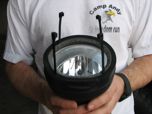

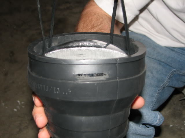

    The aluminum bumpers can be done the same way as the original post. The only difference is the fittings.

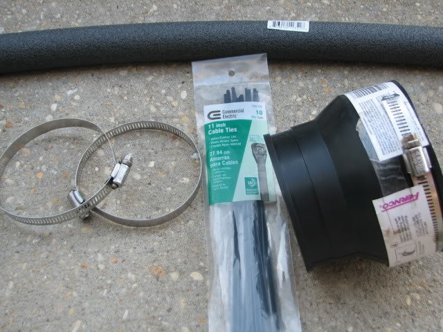

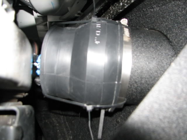

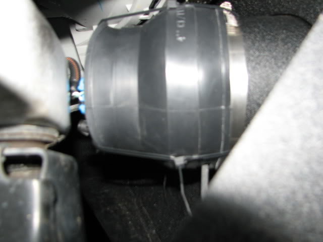

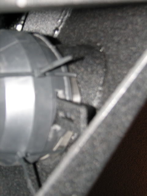

    I found some rubber fittings used the adapt clay pipe to pvc pipe in the plumbing section at Lowes. What I used was 4" to 4" adapter. Just have to make sure that it is for clay to pvc. The adapter will measure 5" on one end and 4" on the other. It also should come with the needed hose clamps to tighten everything down. The fog light will slide into the adapter and fit snug where the adapter reduces down and the hose clamp will hold it in place.
    I've had this setup for about three weeks now and everything is pretty solid. The lights don't bounce driving over rough road, which was surprising to me.
